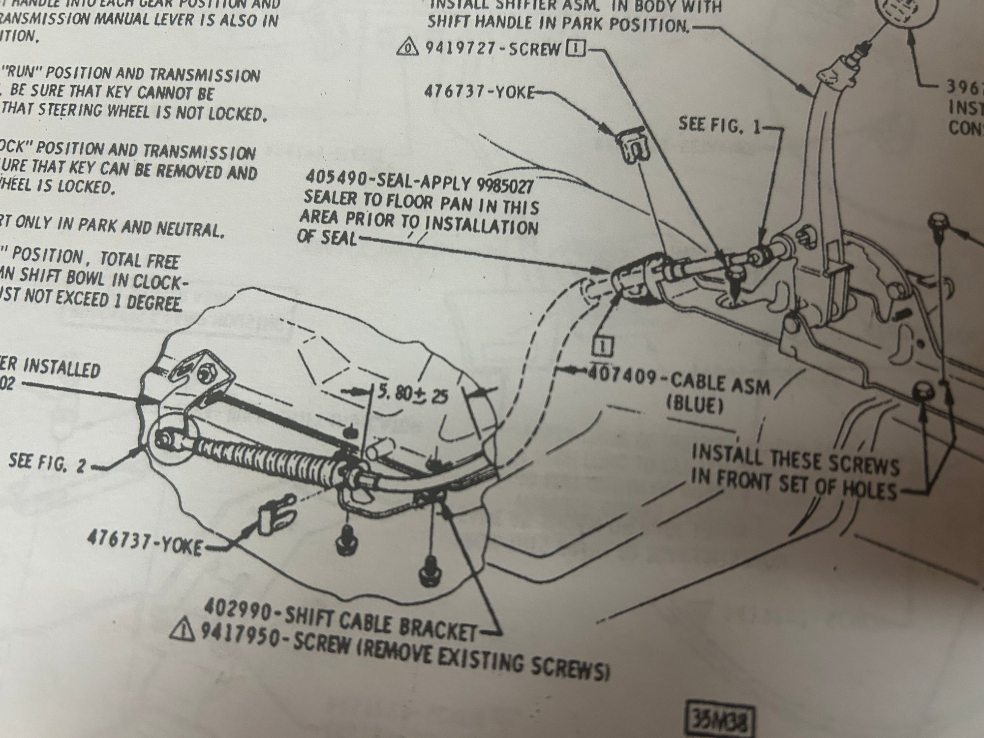

Thanks for the thorough research and response. I solved the cannister issue and have a 72 service manual, tnx. I did inspect the ATVM and replaced the short rubber hose at the VM. I am using manifold vacuum off a Quickfuel carb that went in last year. Drove Sat. and coming up mountain (2900-3900 elevation change), I did not get the stutter/hesitation as before but my RPMs were going up higher than usual and felt like I was losing torque or trans /TC was slipping. I will bring up the timing and check the vacuum. On another (unrelated) note, the TH350 had no issues until now, but ever since I installed the rebuilt unit (2006) I can't get the floor shifter to manually shift into 1st gear (it will when in automatic). The service manual shows what looks like a slot /pin adjustment (fig 2) but mine doesn't look like that- plz see pics and diagrams below, tnx!

Before I mention a couple things, what you're saying is the only item you addressed was to R&R the short rubber vacuum hose between the ATMV & the hard steel pipe, drove it up the mountain you did not get the stutter or hesitation as before, except that you felt like you were losing torque or trans /TC was slipping & your RPM was higher. If all you did was replace that piece of vacuum hose & it no longer stuttered or hesitated it might suggest you better evaluate your overall vacuum on this engine. You should be able to develop a steady 17"Hg vacuum. Use a vacuum gauge & measure your vacuum.
As you noted previously, and I'll reiterate, you have a TH350 behind a 455 BBO + a reman. torque convertor with slightly higher stall & shift kit. Here's the extent of my knowledge. I know the TH400 sat behind the 455 from the factory, not the TH350. I know the TH350 is a direct bolt-in behind a 455 BBO. I've followed, heard, read about folks who bullet proof a TH350 when sitting behind a 455 BBO w/ no issues. I've also heard the exact opposite. Shift linkage differs between TH400 & TH350. That's about all I'm good for, unfortunately. Suggest you patiently await other members w/ more knowledge than myself regarding your latest questions. Again though, I'd measure your vacuum w/ a vacuum gauge to ensure you're developing a solid steady vacuum which could be part/parcel especially while under load (1) increasing in elevation (2) a TH350 sitting behind a 455 BBO (although, to this point I'd think if you matched up the TH350 correctly this wouldn't be an issue as long as it was done right) - there's obviously going to be more torque required during mountain climbing - will the TH350 handle that worse or better than the TH400 I am not the expert to help on this. Check your vacuum. Good Luck!
