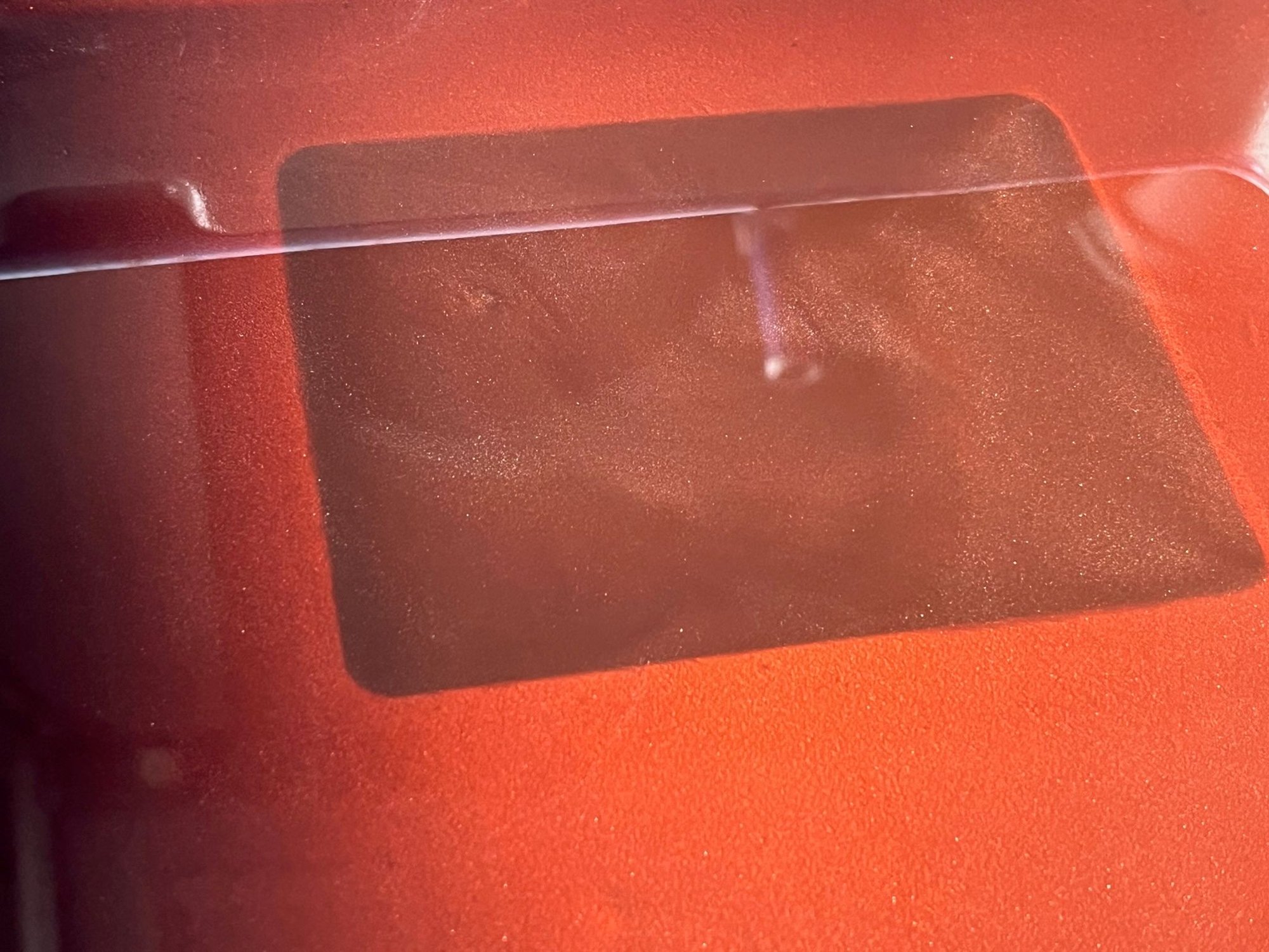

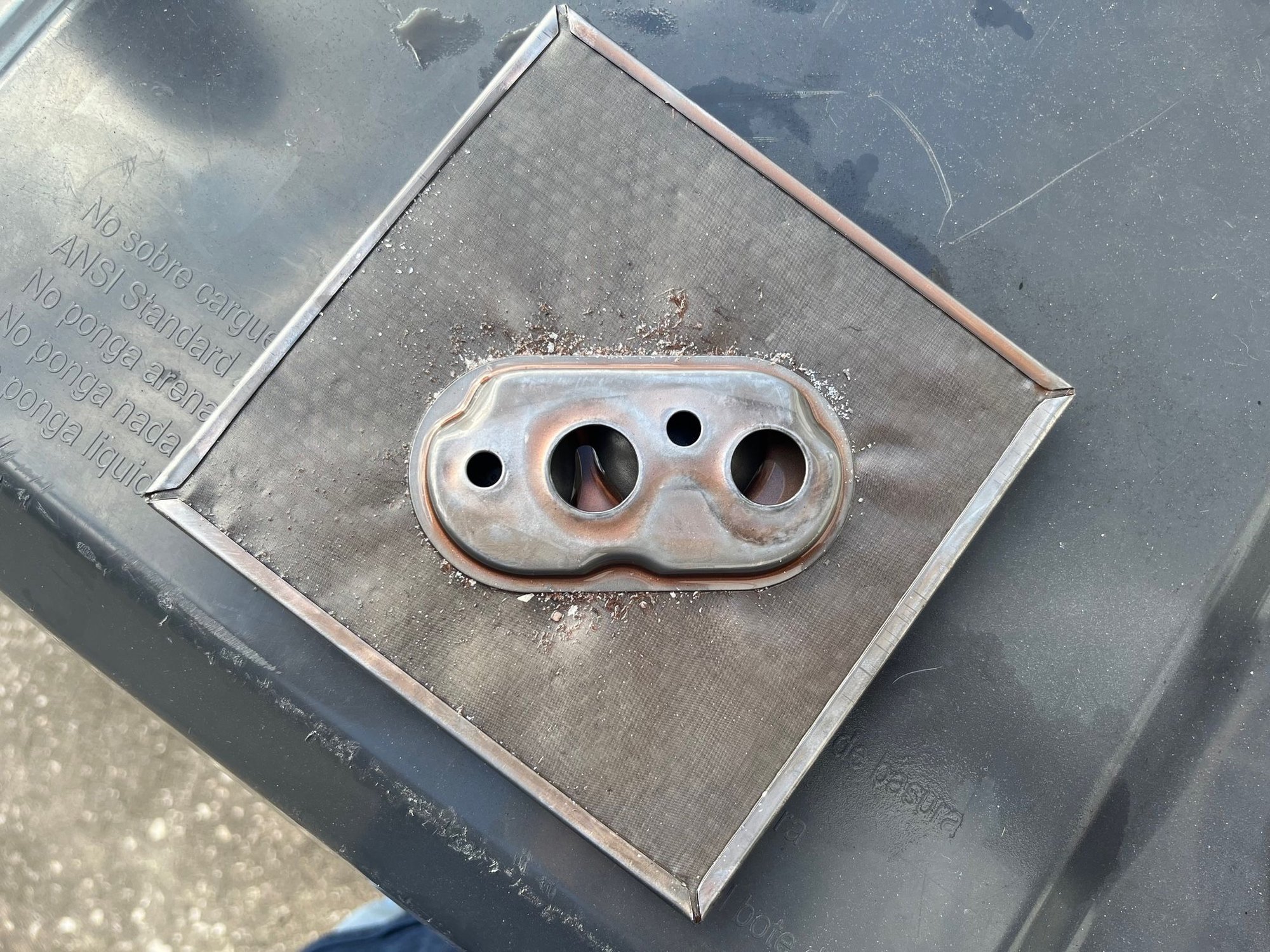

Trans started slipping between 2-3 last night and after draining some fluid out, found it dark and somewhat milky. So pulled the whole pan and found a good amount of medal debris / shavings. Was rebuilt just under 2 years ago and has just over 6k miles on it at this point.
Any thoughts if a fluid and filter change will be enough to remedy the slipping issue or am I outta luck on this build?

Oh man that doesn't sound good or look good.
My fear has always been having any part of the powertrain rebuilt and it going bad in a fraction of the time that the factory components lasted.
Two schools of thought on the fluid replacement. Replacing fluid can hurt the transmissions operation on well used ones. Or have no negative effect at all. But thats in regards to long term usage. Under 2 years and 6000 miles is a different story. However the damage seems like long term usage. My gut tells me changing the fluid will kill it completely... Hope i'm wrong. Would be awesome if you have a long term warranty on it...

You won't make it worse by putting in fresh fluid and seeing what happens. That's not a horrible amount of material, but that is a lot of shavings. My rough guess is a bushing or thrust washer is getting chewed up - usually either bad clearances (which should kill it pretty quickly) or fluid flow problems. Double/triple check you fluid cooler to ensure it's not clogged. I always run a filter on the return line from the cooler - the black magnafine filter is awesome and available under several brands (e.g. Raybestos), usually under $30.

The line pressures are an immediate way to pin point the circuit leak. A slip is more or less a leak.
If that's planetary, support, friction/steel or torrington etc shrapnel, no amount of snake oil or fresh fluid will fix it.

It's absolutely necessary to rebuild or replace the converter whenever there's trash found in the pan. There will be a similar amount of trash hiding inside the converter waiting to kill the next trans.
Does it also slip in reverse? If so then the direct clutch is dying.
