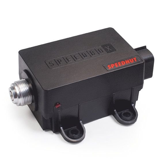

Hey All, here is what I'm up agains't. My 56 88 Holiday has 65 Motor and transmission in it. The original transmission would spin the speedo cable. Somewhere in the 60's Olds used the left front wheel to run the cable. Now I'm using a heads up display for my speedo. The 65 trans was never machined out for the cable hookup. I want the original speedo to work. The only thing I know to get a different tranny. Anyone else out there have a better idea? Thanks for any help, Dennis

Your two options are to get a different transmission with a speedo drive provision or get one of the GPS speedo units that have a cable output.
https://www.speedhut.com/ecommerce/p...peed-Converter

Hey Joe Padavano, just wanted to say thanks for your help. I took your advice and bought a speed box. I installed it yesterday and drove my 56 Olds today, it works just great. I am so glad to have the factory speedo working. Thanks again, Dennis

The speedbox looks like a nice solution to a variety of issues. So, this connects with a cable directly to the speedometer, no longer connected to the trans? Between trans changes, rear end, tires, I feel I could play around for a long time and still not have an accurate speedometer. I currently use the Waze app on my phone, but this would be nice.

it is so nice to get the gps off of the dash and this speedbox works great. Wasn't cheap but cheaper then replacing the transmission. I seen one of these speedxoxes several years ago but was well over $700. I love the fact that it's right on the on the money and tire size makes no difference. It was easy hook up on an old car.
