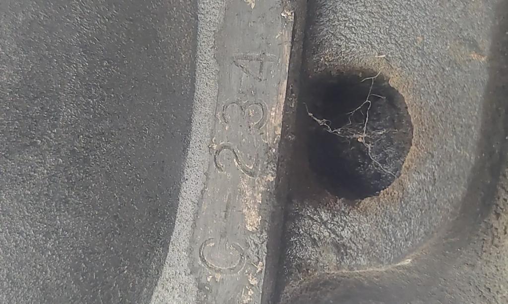

Anyone know what the axle ratio is for the 6.5” rear end in ‘63?
I’m trying to confirm I have the proper driven and driven gear combo in my TH350 trans and this info is part of the calculator.

There were only three options: 3.08:1, 3.23:1, and 3.36:1. The ratio code will be stamped on the cover adjacent to the RH axle tube. A, B, or C are the codes, respectively.

It isn't a tag. It is stamped right into the cover near one of the bolts

Yup I found it.
C-234. Looks like that would be the 3.36. So I have that and my wheel height of 25.5”. I think I can use that to calculate which gear combo I would need
