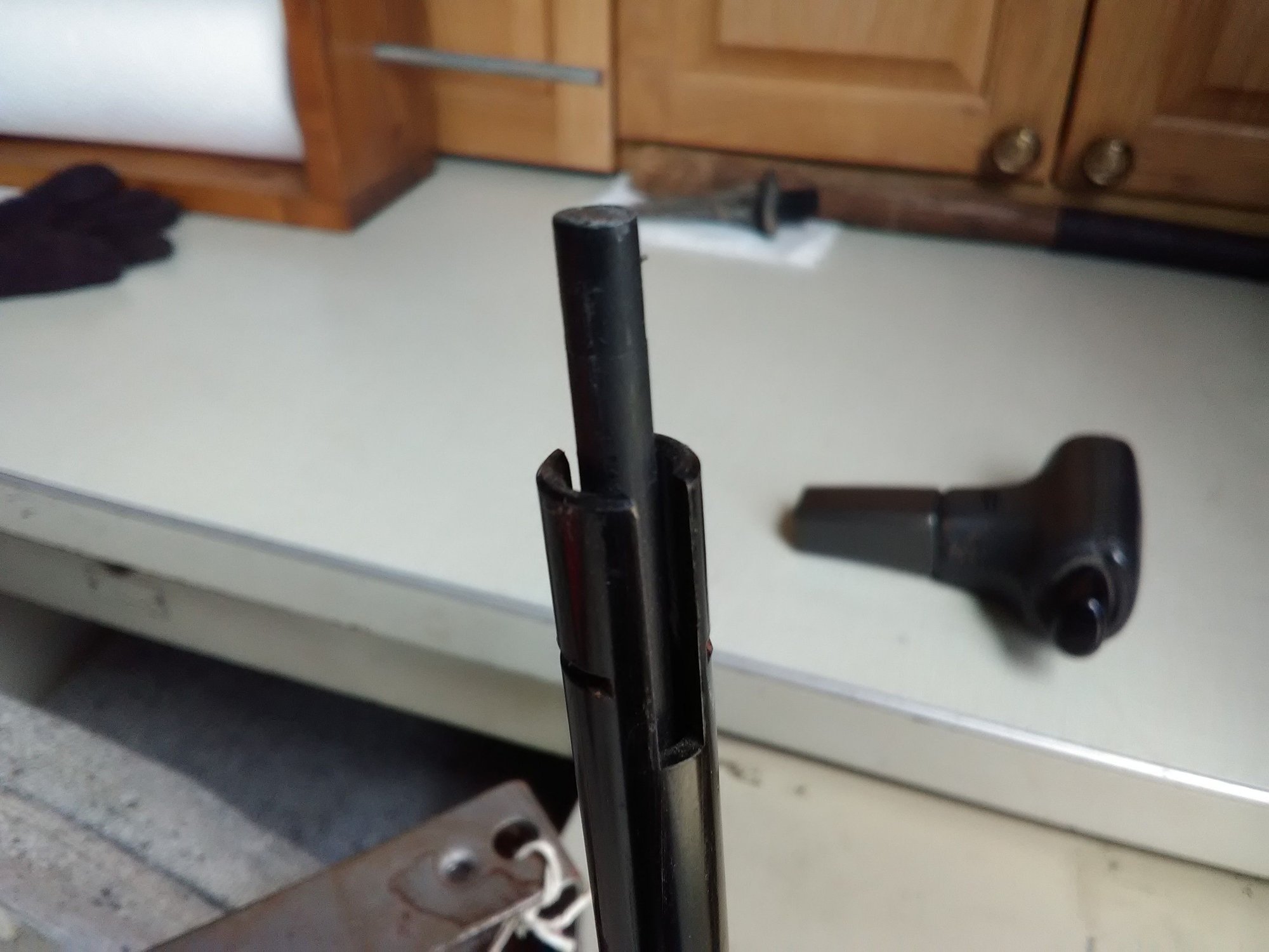

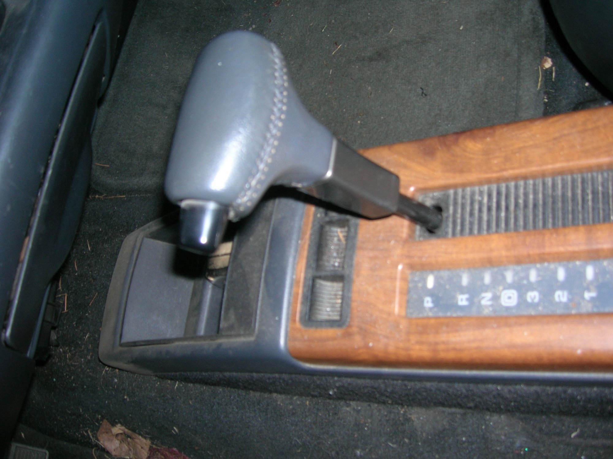

Maybe these photos will help with your efforts...

CRUZN 66
Yes, absolutely, your photos and input are wonderful.
+-1/2 hour ago found a little "round toit" so decided to take a look for my keeper "right under" the ****, where the round metal shaft goes into the ****. "Dang, mine ain't got one there, "under" the bottom square of the ****. So back in I come to the computer to get more/better "splain'n" where the heck that keeper may be and how to get at it.
And I see specific photos ya posted of my handle. "Ohhh, I didn't look "there" for the keeper"!
So, now I've been back out, pulled the keeper very easily with a wine cork corkscrew. May be the only time in my life I ever use a corkscrew, but it happened to be in my drawer of do-dads and small screwdrivers I was searching through for something to work with to pull the keeper. "Ay yup, worked perfect and so simple". Hard part was knowing where to look!
With handle removed, my inner shaft plastic post sticking up out of the metal round stock is the same as yours, though mine is white. "Maybe" an indication of the lack of lube on mine, and possible graphite on yours. Which brings up my next question.
Assuming my plastic button nicely projecting and with a flat top (the same as yours) out of my round metal shifter shaft simply needs some lube (graphite maybe?), what might ya suggest using?
All mechanisms seem to activate related to use of the brake. "Without" the "U-clip" back in place, and holding down pressure on the shift handle in place, there is an audible and felt click as soon as the brake is depressed. Never seemed to have had that with the clip holding the handle on, but never knew enough to listen/feel for it before.
Am I simply making an *** of myself "***"uming I simply need lube on that plastic button protruding from the metal shifter shaft?

I would just spray some WD-40 down the shifter shaft as well as in the handle opening to lubricate the button actually in the handle...If the shifter functions properly by pushing down on the plastic button, I doubt the shifter itself is the problem, but lubricating it can't hurt... After lubricating the shifter as well as the handle button, reassemble and see if the button still sticks...
