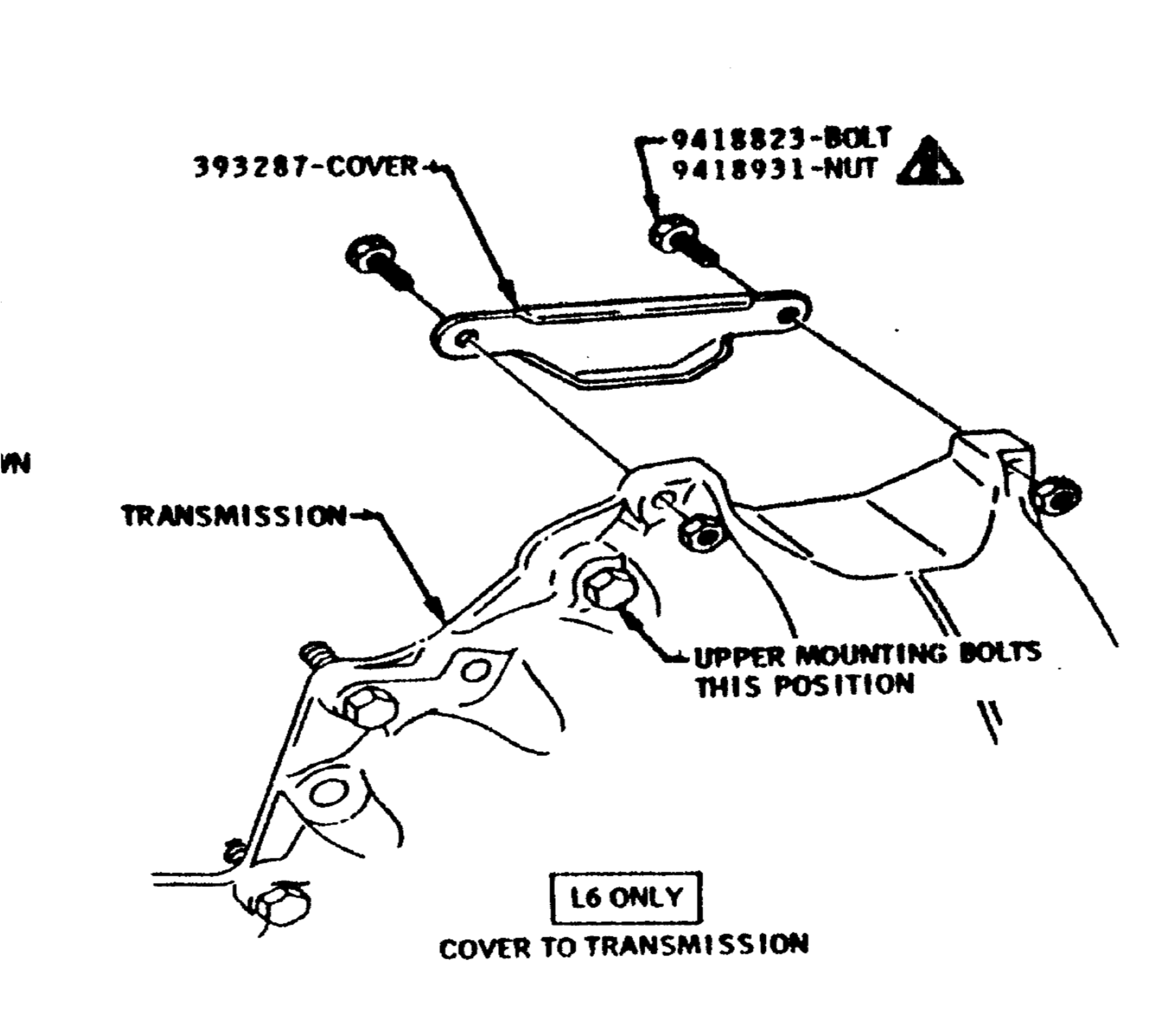

The ST300 (Jetaway) used behind the six had a dual bolt pattern bellhousing. There was a small closeout plate that went at the top. This is shown in the PIM. These were not switch pitch.

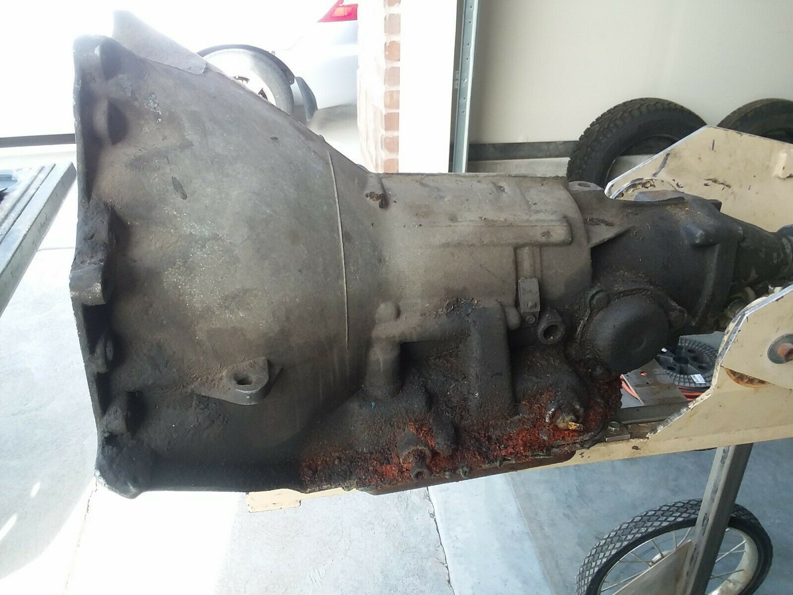

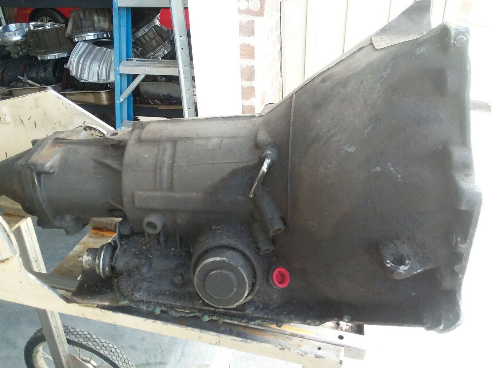

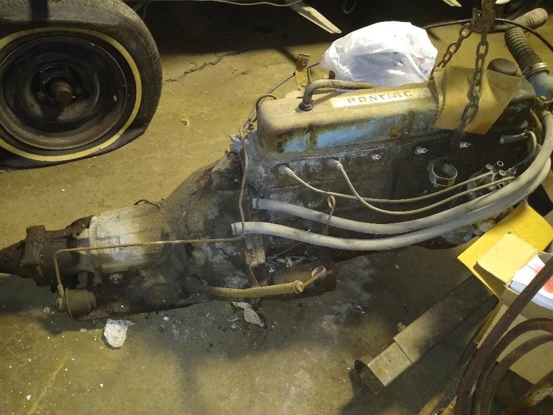

I'll add that pretty much every Pontiac "Powerglide" has ended up being an ST300. Here's an example. Note that the modulator is on the passenger side. Also note the short tailhousing.
A real PG has the modulator on the driver side and a much longer tailhousing.

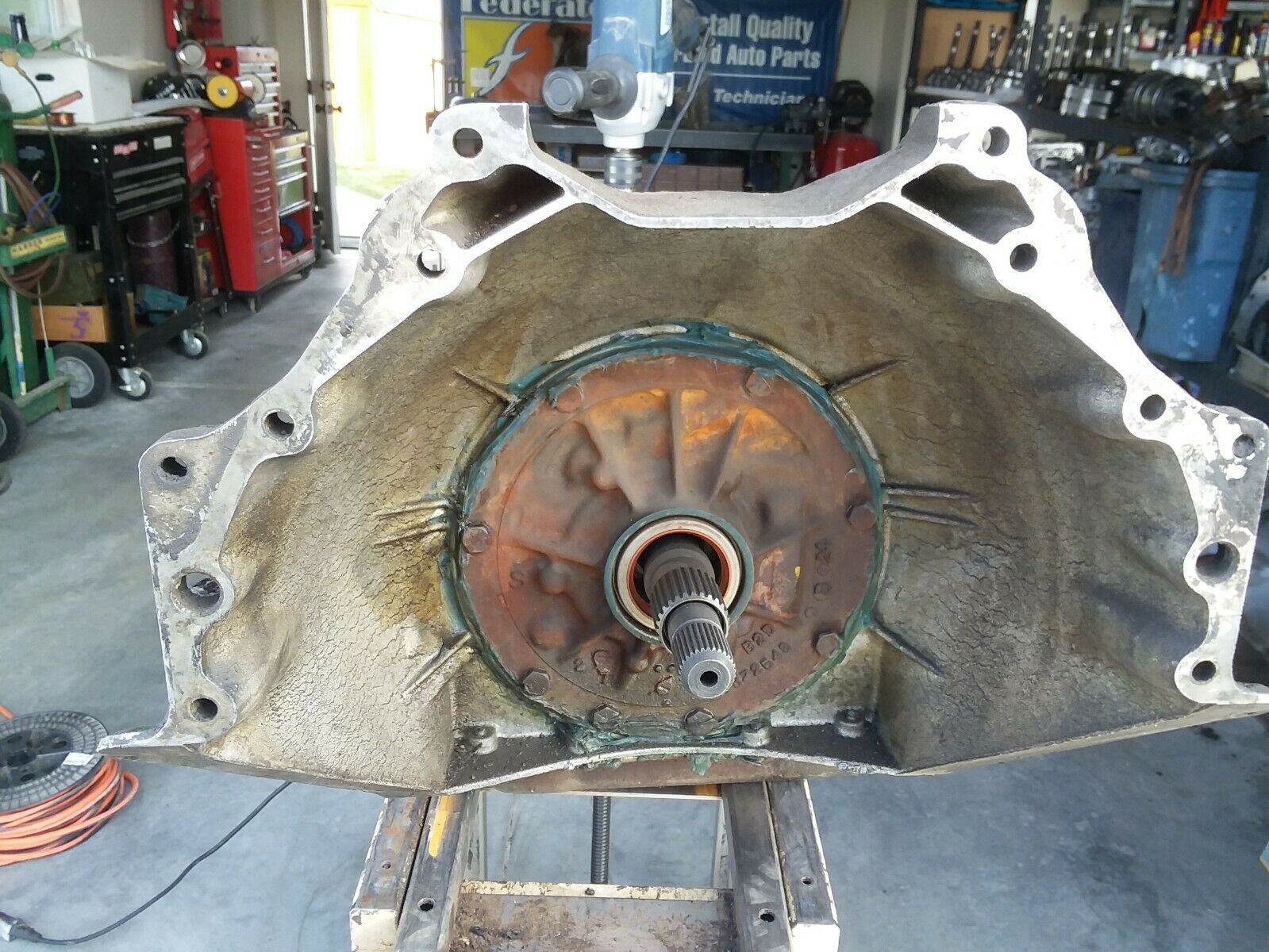

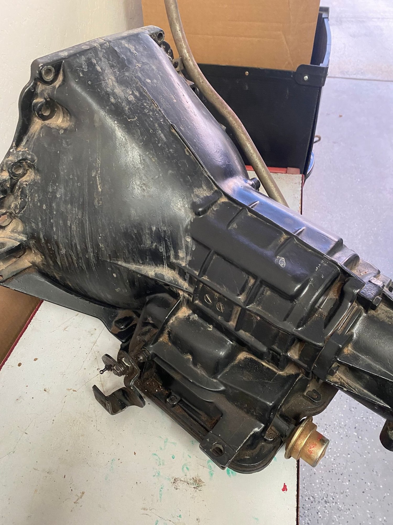

And to settle this once and for all, here are photos of a unicase Powerglide. Note the driver side modulator and longer tailhousing.
