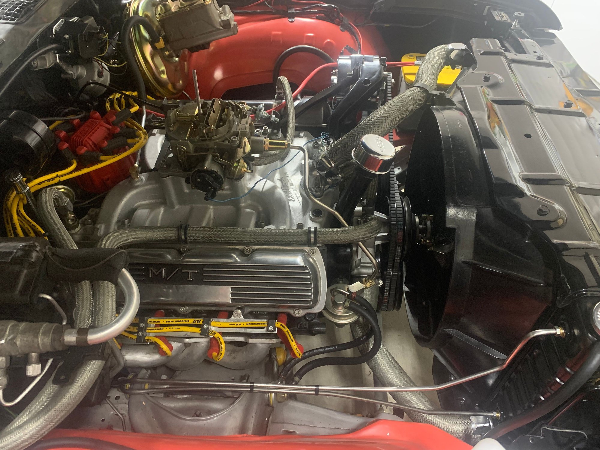

I used 3/8" rubber trans cooler hose from my trans to my external cooler and was able to route them along the oil pan with no issues. Mind you, I have a 455 and headers also, and I did it with the car on the ground on jack stands.

i installed new lines with motor and headers in place and the car on the ground. I was also able to route them around the headers with some minor tweaks.

Thanks, I used Inline Tube stainless lines. I messed up and ordered lines for a a 72 which has the fitting on the radiator for the upper hose a lot lower. The 70-71 lines have a longer drop on the upper line. I think with routing them over the A-arms both would have worked for me.

Hey Gary, I do have a 455 and the headers are hooker comps. The lines are for 72 only but my radiator is a 70 so the top connection is much higher then it would be on a 72 model. I think that actually helped me get the lines up on top of the control arm. I don’t remember the exact bends I made but I know I did open up the areas circled below to change the directions of the lines, in fact that’s where most of the tweaks were made. I connected the lines to the transmission and took the top plate off my radiator to give me a little flexibility. Then I basically just grabbed the lines with my hands and pushed and pulled on them to get there where I wanted.I took the lines off and back on a few times to make some minor tweaks. I did it by myself with the inner fender in place and the car on the ground, it took me a few hours.

Well, they're in and not quite as pretty as yours but look decent. I ended up getting the set from Inline Tube since you had good luck and the upper line re-bent easy and went in nice. I just did it by hand. The lower one, I had my brother come over because it was a little more complicated. He brought his bending tool and we straightened the big curve out and tried to re-bend it. We kinked it because we didn't put any gear oil on the bender surfaces and where we kinked it was where we straightened out (friction issue). If we'd have lubed it, the line probably wouldn't have kinked.
I decided to order a SS line from Inline Tube the length of the first line (55 inches) only straight with the double flairs and fittings on each end. In the meantime, I used the one we kinked to roughly form the line to fit and to use as a template to bend the new straight tube when it arrived. Inline made it up and sent it in two days to my home. They charged me a reasonable amount for this "special order" line!
My brother is the "angle guy" in the family and he came over and we spent a couple hours bending the line and installing it on the car. It looks pretty good and I'm happy. And, they're nice and shiny.
The lines are moved outward away from the frame and headers and nothing to rub on them. I'm going to fabricate a line holder to keep it another 1/4 inch away from the A arm pivots. I've sat the car on the ground and moved the front end up & down and it won't get close.
I have another set of SS lines from another company that I'll be listing on the forum shortly. They are listed as 68 to 72 lines and are very nice.
