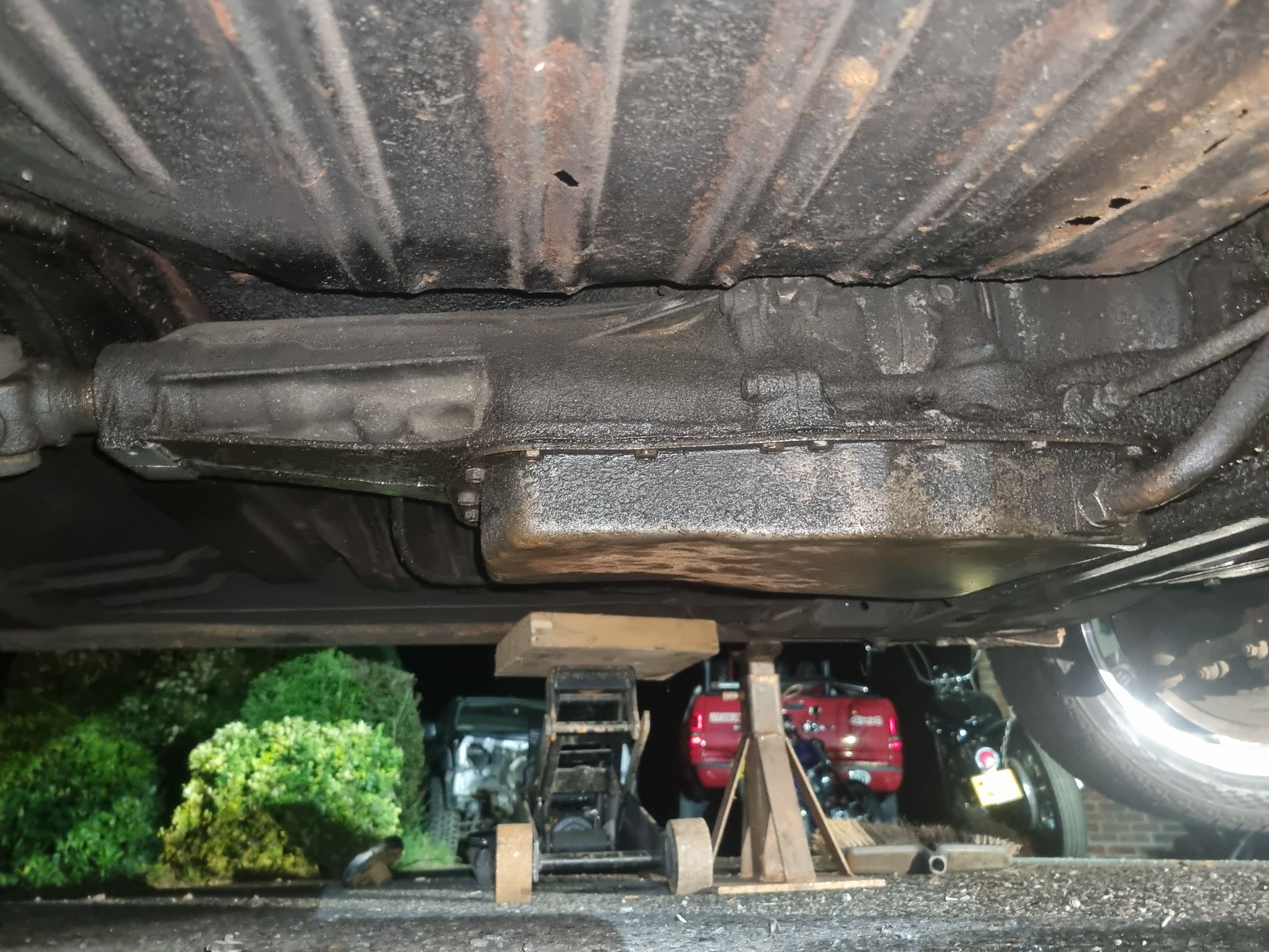

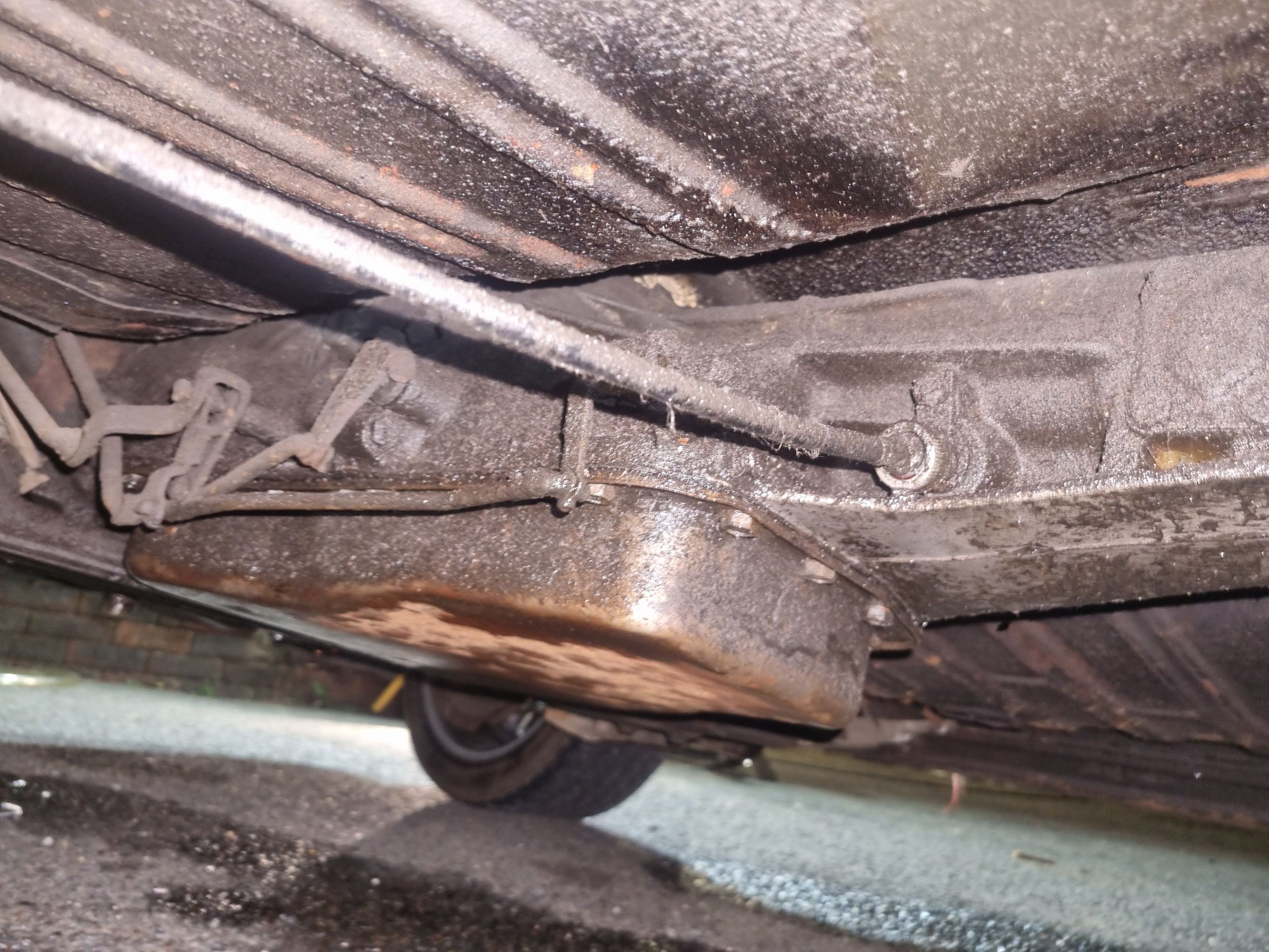

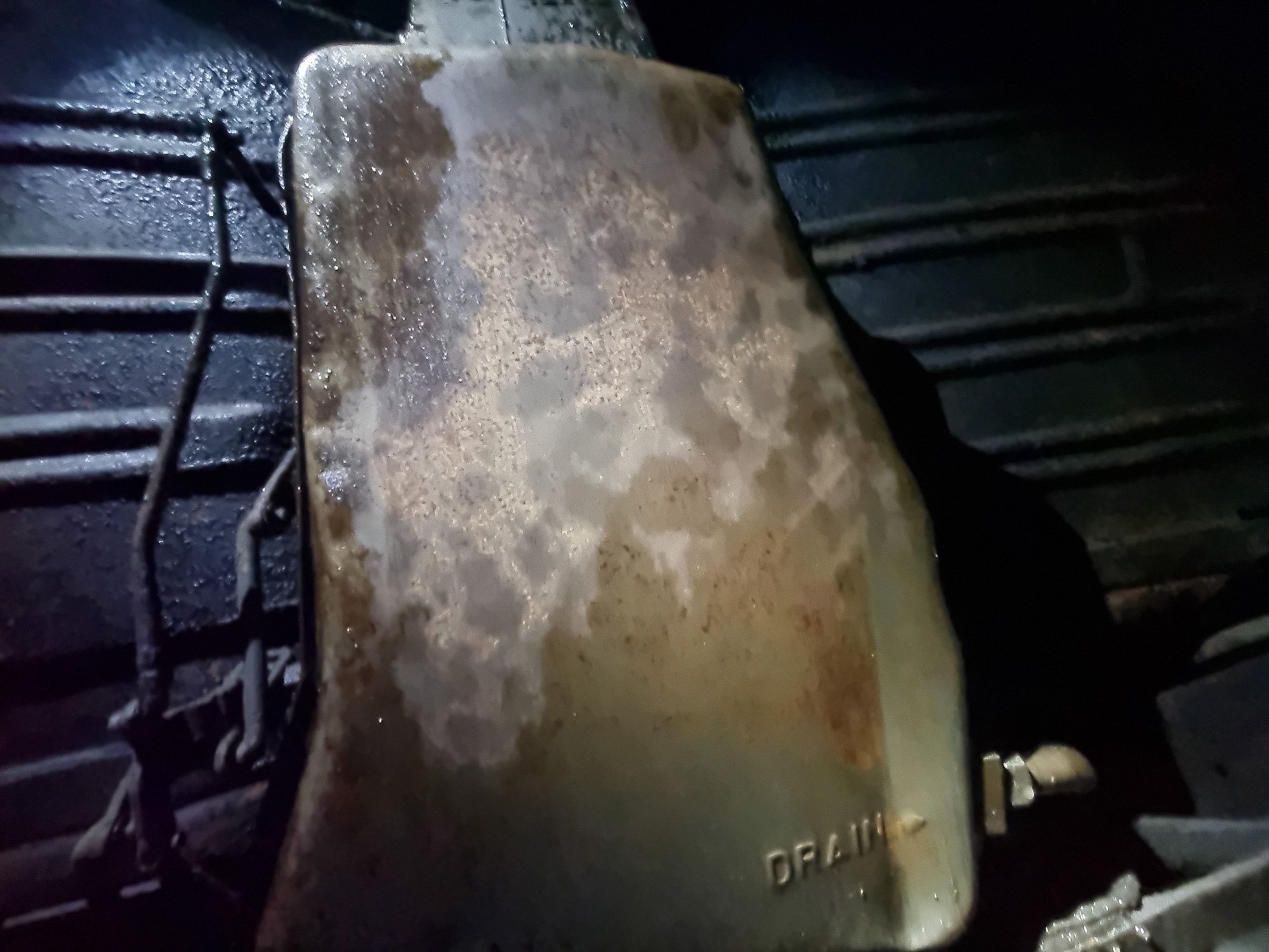

I am new to the oldsmobiles and want some info on my trans, the engine is a 396 ci in a 1962 rocket 88, can anyone tell me what this trans is, and if there is anyway to help it change better without loosing drive for a second when I put my foot down, I have adjusted the TV cable and ir has new oil which did make it better, and if anyone knows where I can buy a good trans filter that would be awsome help many thanks,

Welcome. Your engine is a 394 first generation Oldsmobile and has nothing in common with the Chevy 396. That trans is the Rotohydramatic 10, popularly known as the Slim Jim. It has a number of idiosyncrasies including that poor shift quality. Trans filters and parts are available from Fatsco.
