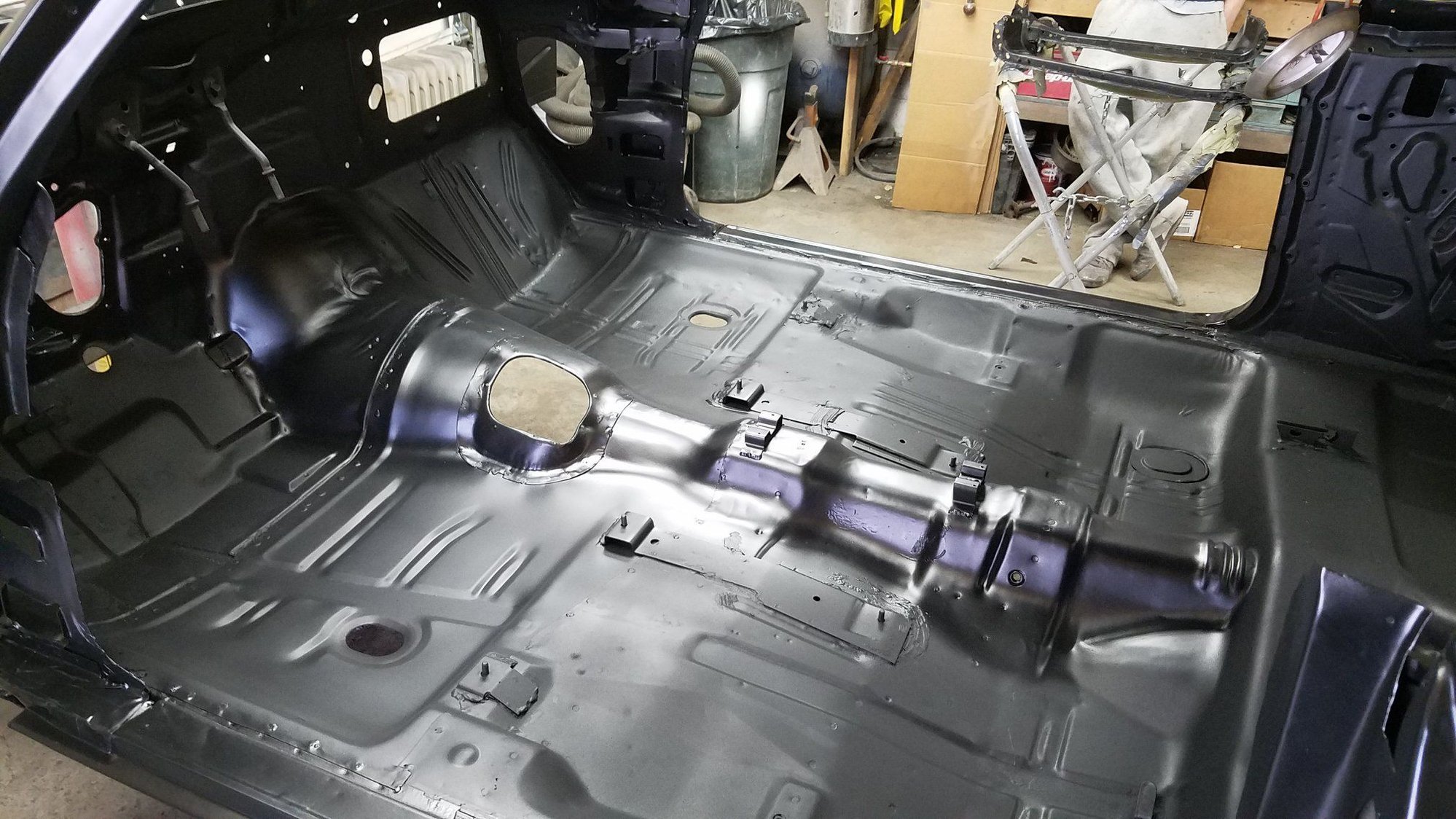

Originally Posted by Eddie Hansen
I always thought the 1969 didn't have a hump? am I mistaken? does anyone have a picture? I have a 4 speed hump out of a 68-69 GTO but didn't consider using it because I always thought they 69 olds just got the floor cut
Here's a pic of the 69 W30 that Tony Bonafide just restored. His uncle had the car since 1973.
Old Apr 5, 2019 | 08:35 PM
73supreme's Avatar
Joined: Sep 2009
Posts: 63
That is how 68 4-4-2 4 speed pan looks, They torch cut the hole, then added the trim collar. If a bench seat was ordered, they torched off those inboard bucket seat mounts.
