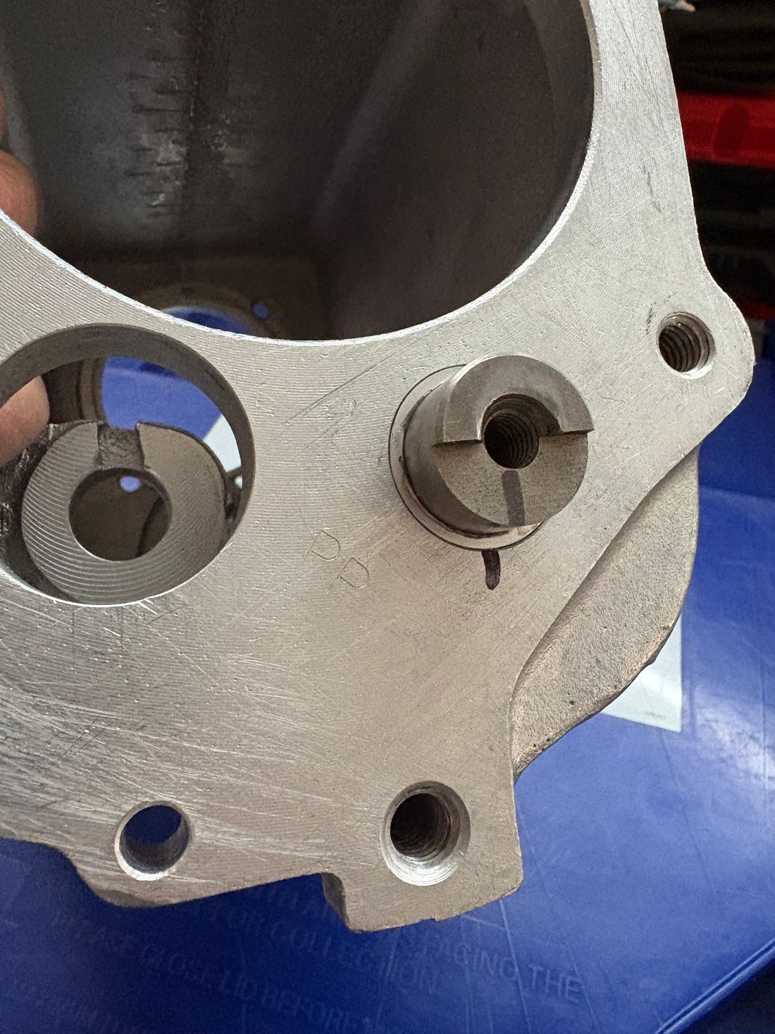

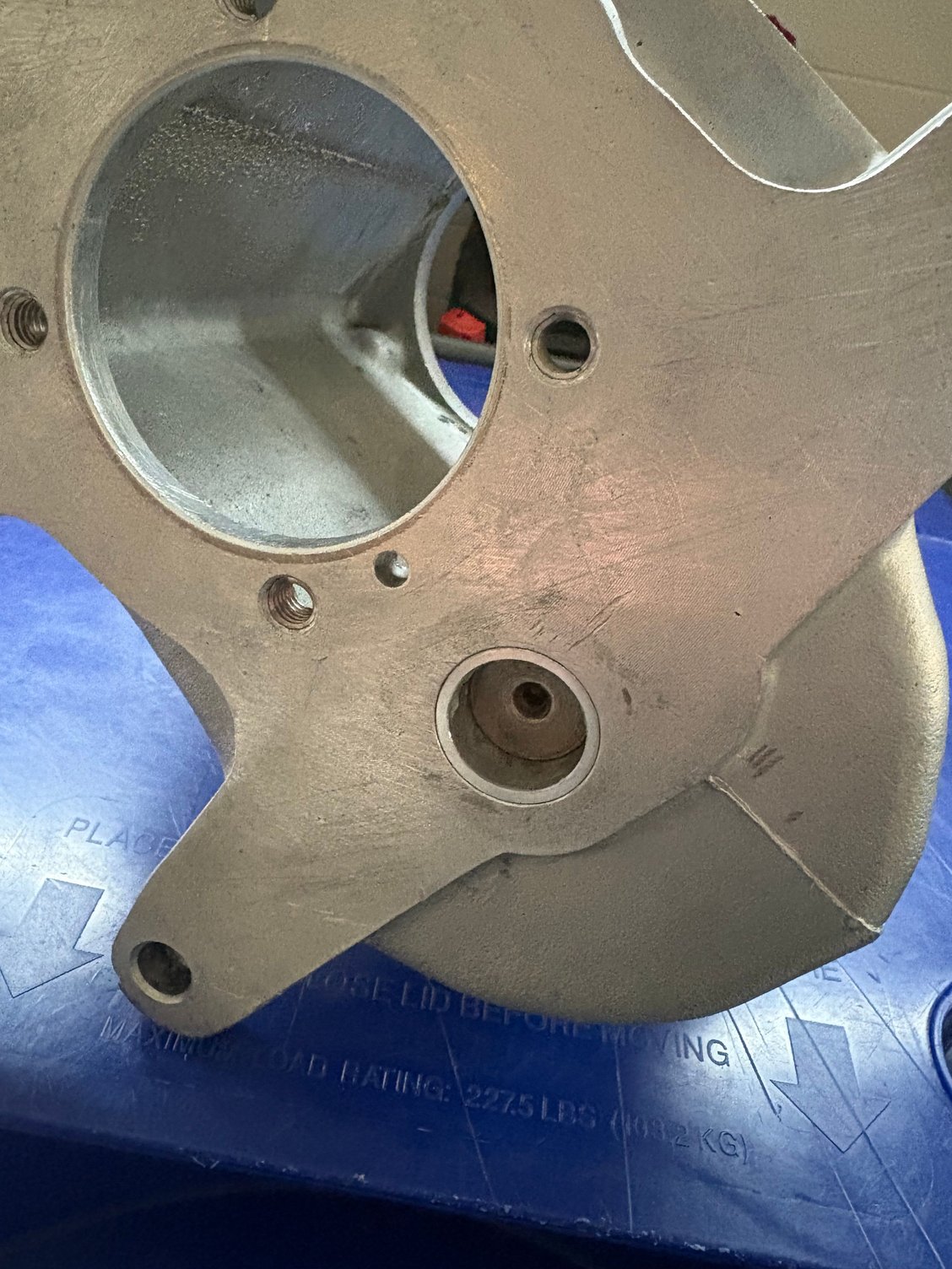

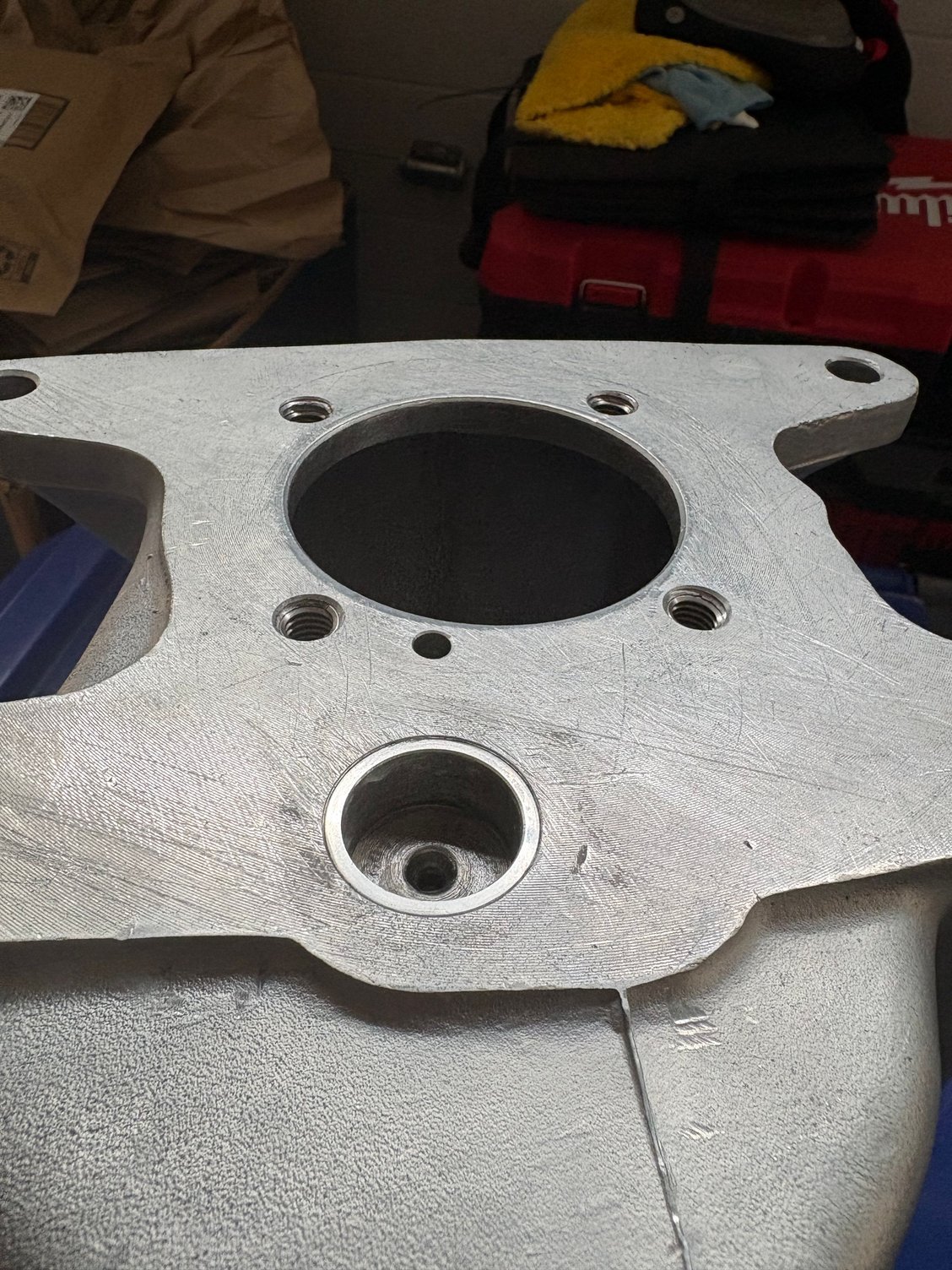

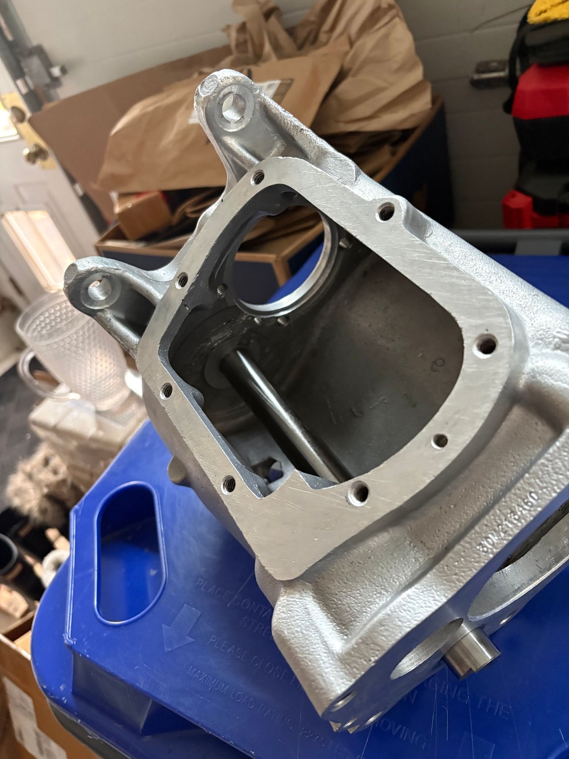

Sorry for not updating this but Steve bushed the Muncie case and I just got everything back together. Steve uses a steel bushing. He bushed both the front and rear holes. He did a great job with quick turn around. He checks everything on the case and makes repairs if necessary. It's literally been a day since I reassembled so I have to see if it leaks or not but its a solid repair and counter shaft was a tight interference fit so I am optimistic this will be a success. I took it for a little drive and it sounded good. Im out of town right now otherwise Id be driving the **** out of it. It looks like a great repair and Steve is very detailed and honest. He is old school and you have to contact him on a land line and I enjoyed speaking with him. He doesn't take electronic payment and only takes a personal check or money order which I find refreshing to be honest. One of the good guys. If anyone needs his contact feel free to PM me.
