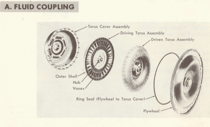

did you find out what it was / is ??... Low oil ?.....not enough oil in the fluid coupling ?
