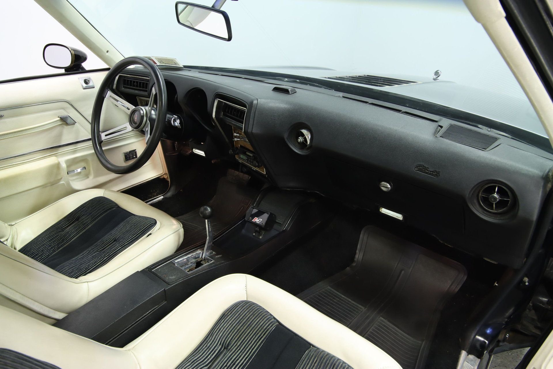

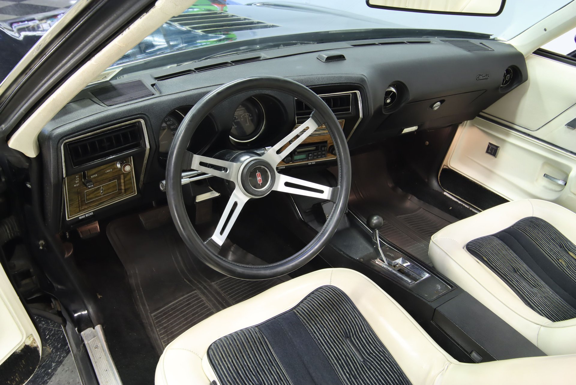

Have any of you ever installed the Hurst Dual Gate with the standard shifter console in the '73-'77 Cutlass? Curious what modifications you had to do to the console. If I do this, I want it to look like the way it was installed on the Hurst Olds. I am thinking I'll have to cut part of the console out.
