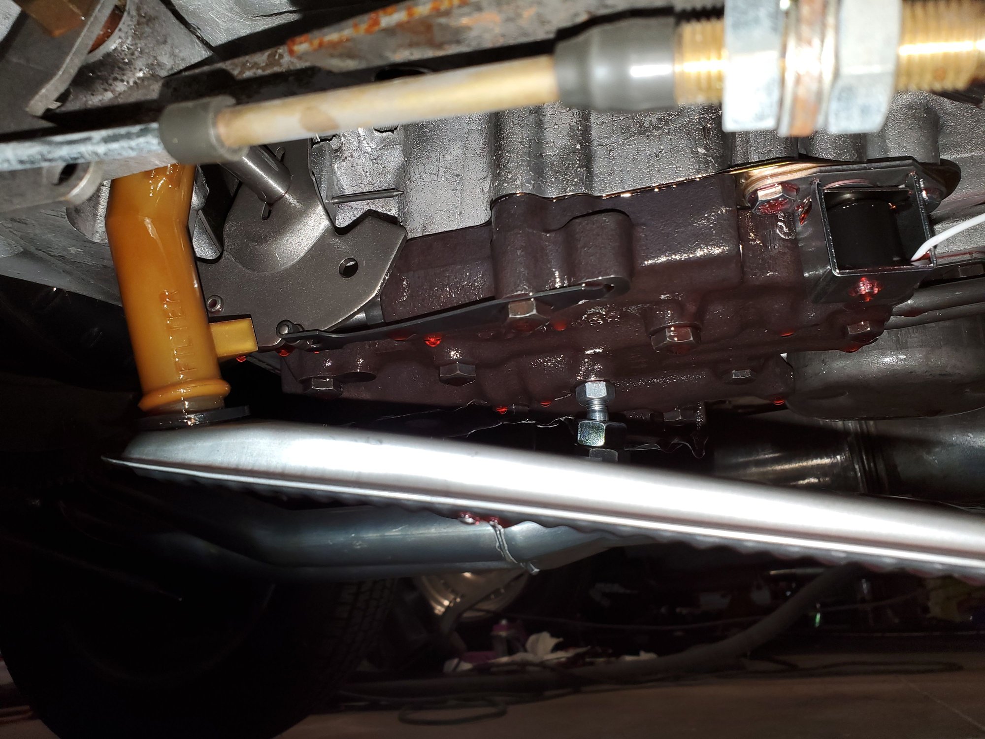

Took off the pan to make sure they used the longer tube, looks like it. But doesn't look like it was sealed, could have happened when the pan came off? What's with two nuts spacing the filter downward?
This is definitely wrong, bolt fell out or wasn't installed so the filter came off essentially.

Looks like they used that as a spacer to force the filter to the bottom of pan,definitely not right.

There is suppose to be a special shouldered bolt and spacer. The filter will flop around. While the setup you have now isn’t 100% factory/correct, it will work just fine.
I have a few of those bolts and spacers. If it helps, I can measure them tomorrow. I’m sure you can find something at a good well stocked hardware store.

Thanks for the offer, I actually did search and get the required parts to make it right.
