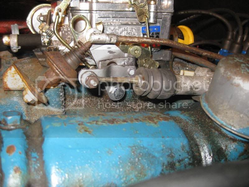

Unfortunately it's a 2bbl. My 64 Vista is a 4bbl, however. The first thing to verify is that the kickdown switch is actually working. You can manually actuate the switch and listen for the click of the solenoid. If that works, then it's simply a matter of adjusting the switch. The plunger has a screw thread for adjustment. And yeah, this photo is a Buick, but the switch is the same.

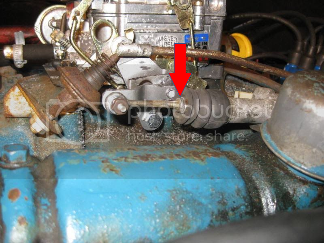

Loosen the lock nut (arrow)
Disconnect the link at the carb lever
Turn the link to screw it in or out of the switch as needed
Reconnect the link to the carb
Tighten the locknut

It's trial and error. ASSUMING the switch and kickdown are working, lengthen the link a few turns and drive the car. See where it kicks down. If you like the kickdown point, done. If not, adjust it some more. Since you have a non-original carb, the stock linkage geometry no longer exists. You need to play with it until it works for you. Making the link longer will lower the RPM at which kickdown happens.
