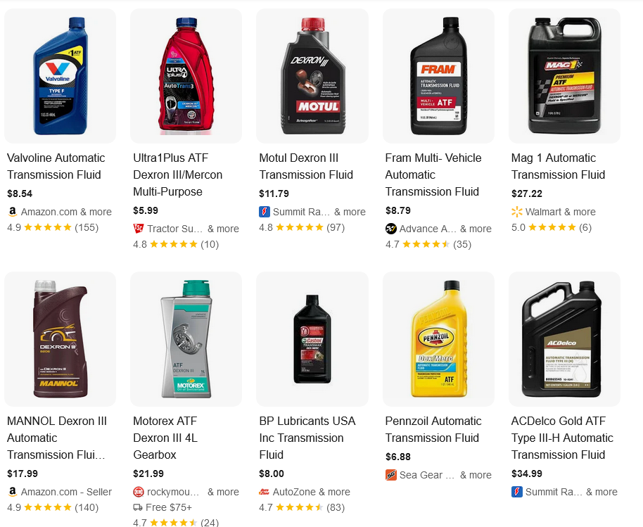

Is dex III readily available at most auto parts stores?
Old Nov 16, 2024 | 02:56 PM
Posts: 18,221
You could at least order Dexron III from most auto parts stores. They would have it in their warehouse even if they didn't stock it in the store. It seems most auto parts stores only carry the universal fluids now.
