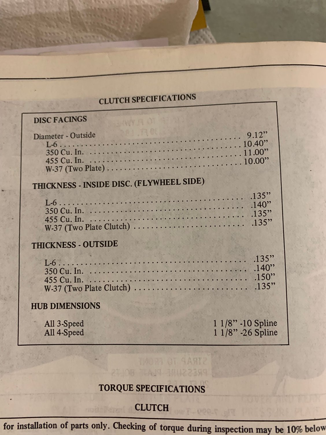

Here’s pics of the W-37 clutch shown in the ‘71 Oldsmobile Service Manual, note the .027 washers…

dc2x4drvr:
Thank you, perfect those are what I wanted to see. Yep those are the washers I have.
