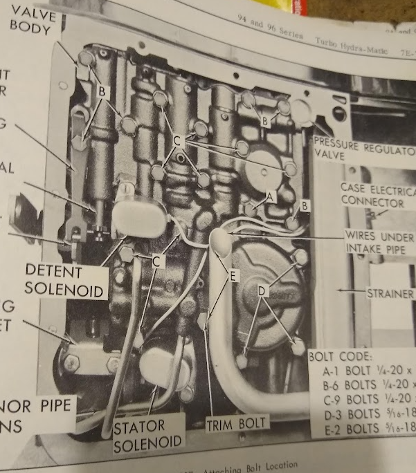

Anyone ever replace the detent (kickdown) solenoid on the THM425? Rockauto shows the one I have attached to this message but to my eye that one looks like it will have a wire on it that's going to be too short. I'm guessing it's incorrectly listed for the THM425 and more likely for the THM400.
Any other options out there?
Cheers!
That wire looks too short
This is the THM425 solenoid (detent, or kickdown). The wire looks much longer.

RockAuto also lists manual transmission parts for a 1966 Toro, which should be your first clue that their on-line catalog isn't trustworthy...
More to the point, the catalog shows that this "shift solenoid" is only used on Toronados with the rare RWD TH400, which should be your second clue that the info isn't correct.
Now, if you look in the factory parts book, you will find that the detent solenoid for the TH400 is P/N 1993620. The solenoid for the TH425 is P/N 1993319, so clearly if a solenoid is listed as fitting the TH400, it won't fit the TH425. Unfortunately, no one makes a replacement solenoid for the TH425 anymore, so either find a good used one, an N.O.S. one, or get the TH400 one and lengthen the wire.

Contact TransGo and find a local dealer for part support. https://transgo.com/
Are you satisfied with your troubleshooting that it's the internal solenoid that has failed? Only reason I ask is the solenoid is 3 or 4th down the factor tree if it's not down-shifting properly.
