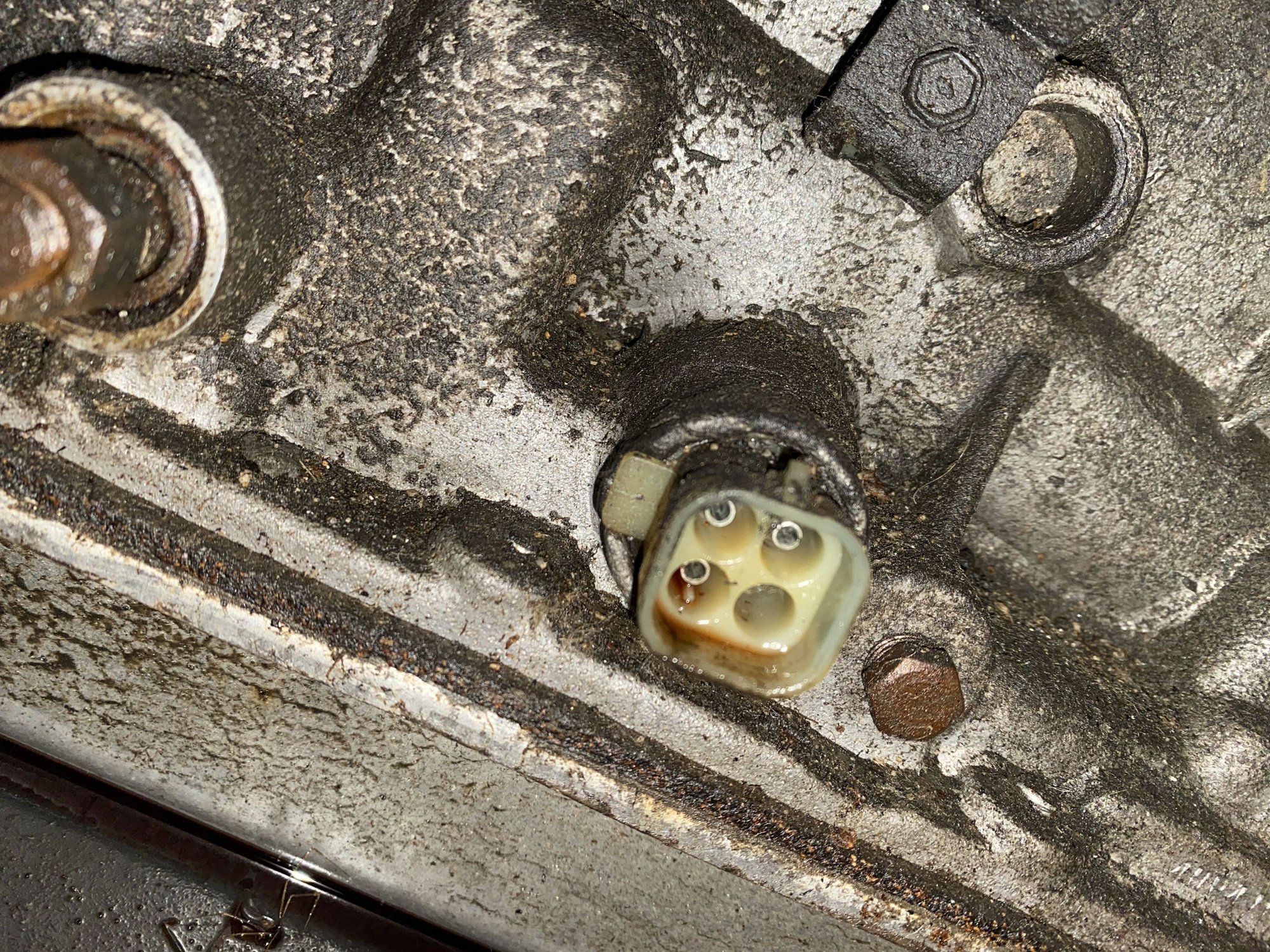

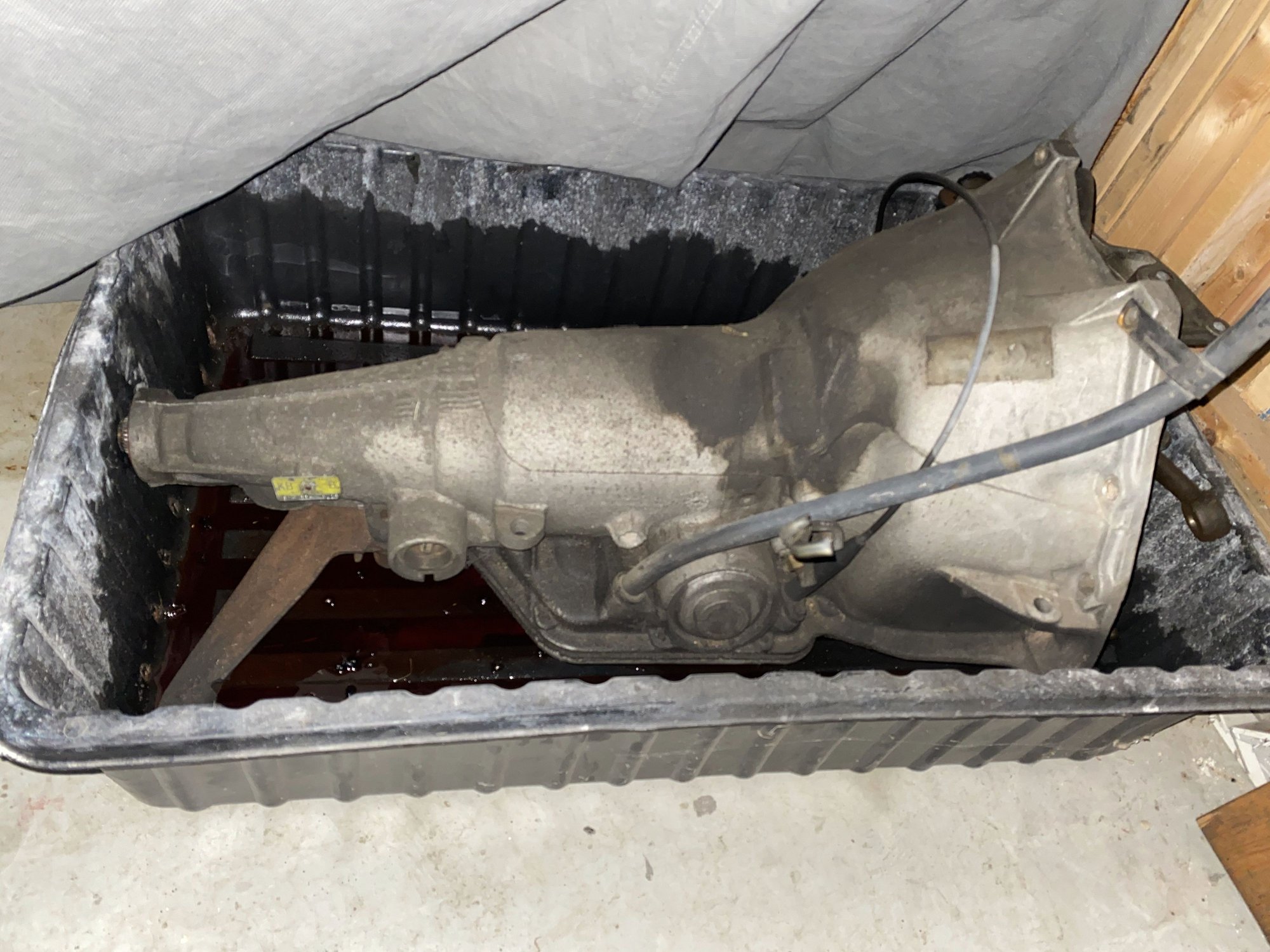

I have found a D&D trans adapter plate for a 700R4, but cannot reach anyone at D&D to confirm if this will also work with a '87 Buick TH200C tranny.
There is no part number on it either. Here are few pics of the tranny....

Old Jan 11, 2025 | 08:47 AM
Posts: 50,802
The adapter plate for the 700R4 has the Chevy bellhousing bolt pattern. Your BOP pattern trans will not bolt up. You need a Chevy pattern TH200.
