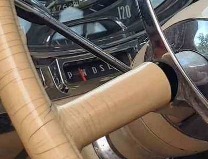

They do line up. When I try to put in park this is as far as it will go. It stays in neutral.
Seeing that, I'm gonna go ahead and guess that rocketraider's theory is the right one.

You do know that you have to pull the lever toward the steering wheel when shifting into park.

As Charlie said^^^ you have to really give it a pull to lock it into Park.
