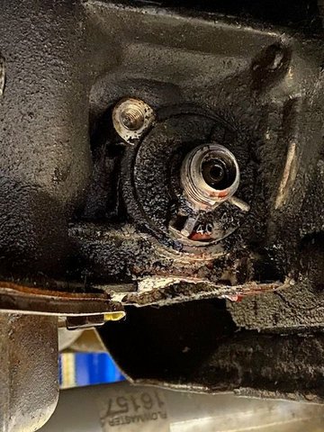

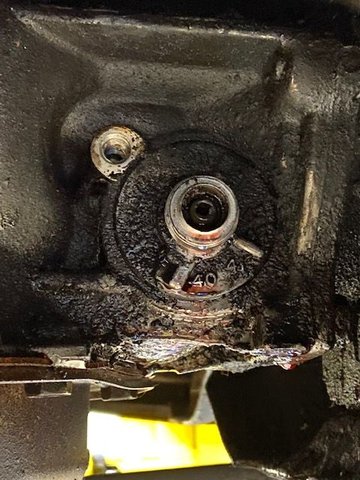

I have a leak from the drivers side of the tranny where the speedometer connects to the transmission. On my Corvette I repaired the same issue on the Turbo 350 by pulling the item they call the "bullet" and replacing the O ring and re-inserting the items and that cured that leak. Well, I have it up on the lift and I disconnected the speedo cable and the bolt and clamp that holds that piece in transmission. That piece seems to be lodged in the fairly tight. What is the best way to remove it so I can put a new O ring on it? I just want to be sure that it comes out by just pulling it out and not some other procedure. Any info appreciated! Below are a couple pictures of the area I'm referencing!

The speedometer housing is held in place by just one bolt and retaining bracket. Due to dirt and corrosion, it might take a little muscle to get it out. Once you do, inspect the speedo gear. It’s not uncommon to find the speedo gear shaft worn where the rubber seal rides.

I have been messing around with it for a bit and after using a screwdriver and a hammer, I have tapped on the three raised sections on it and can get it to turn slowly clockwise and back again counter clockwise?? I'm just curious if this is something you can spin around freely when it's not dirty and greasy. The piece on my TH350 in the Corvette slid right out. I'm just trying to be careful because I have had a history of getting carried away and breaking some things....LOL! I also tried threading the end on the speedometer and then using that to pull on it a bit and it really didn't seem to want to come out any!

The only thing that holds the speedometer gear housing in place is the bolt and housing retainer. If the bolt and retainer is out, the housing is stuck on the O-ring.
Spray some penetrating oil around the housing. Screw the cable back onto the housing, get a long screwdriver, and catch the tip of the screwdriver behind the cable collar, and lightly pry against the case.
If the housing will rotate, keep at it. It will come out.

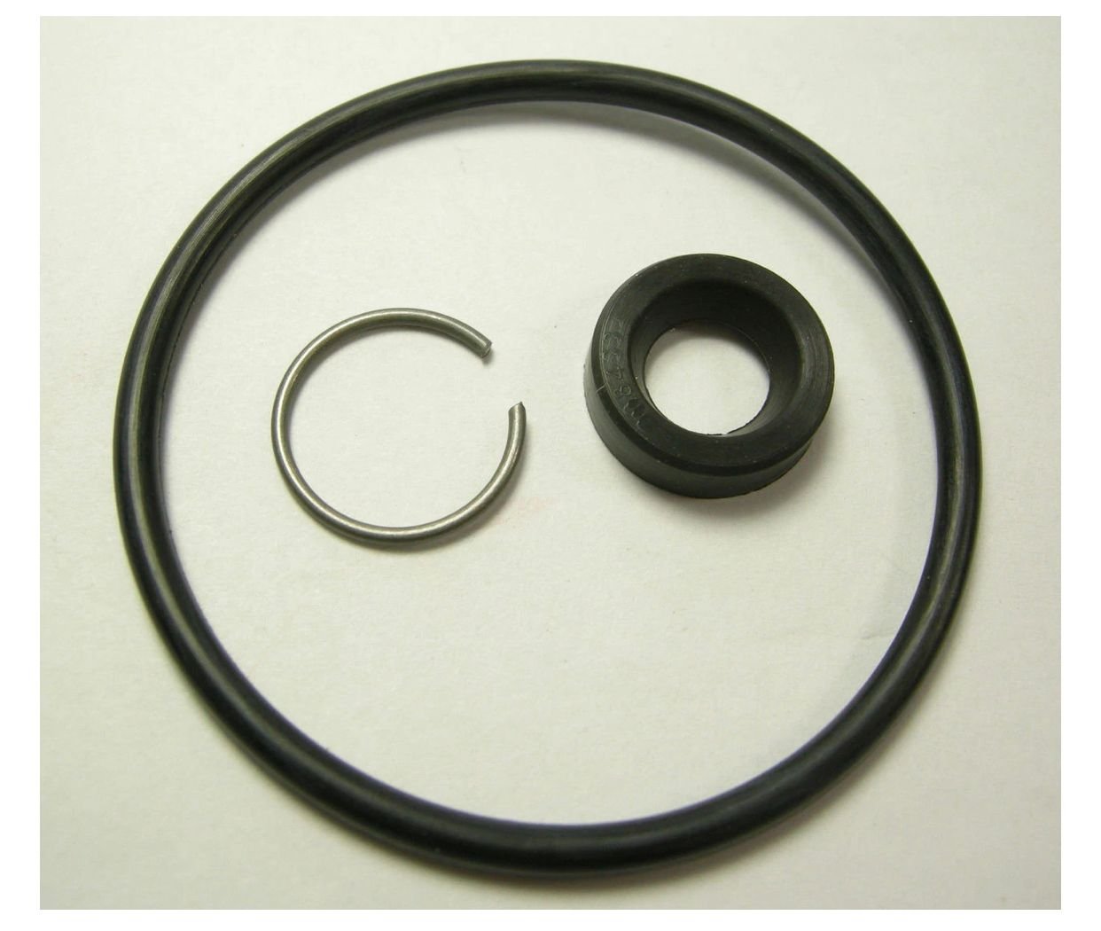

Is there a seal in the speedometer cable area too that can leak and might need to be replaced.....besides the O-ring! I've searched a couple other threads on leaks and it sounds like that may also be a possibility for the leak. I'd just as soon replace that too because I don't like "fixing" things multiple times.

this is what your looking for. Go to any transmission shop, chances are they have a coffee can full of these seals and O-rings. These seals are included in every transmission rebuild kit, but if the transmission they are building is 4wd or uses a speed sensor instead of speedo cable obviously they won’t be used for that rebuild.
The large o-ring goes around the outside of the housing, the small seal goes inside and seals the housing to the speedo gear. The small clip keeps the small seal from walking out of position. You can stack 2 small seals on the housing bore (seal,clip, then another seal) if the leak is persistent.
