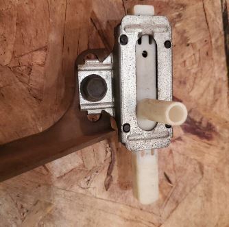

I have a 1968 Cutlass S Holiday Coupe with a Jetaway. When I bought it I noticed that the pedal kickdown switch was unplugged. I pulled the switch out and attempted to disassemble it to clean/lube it. The plastic was so brittle that the whole housing cracked on when I tried to pry it open. So now I need to order a new switch. Here's a picture of what I currently have:

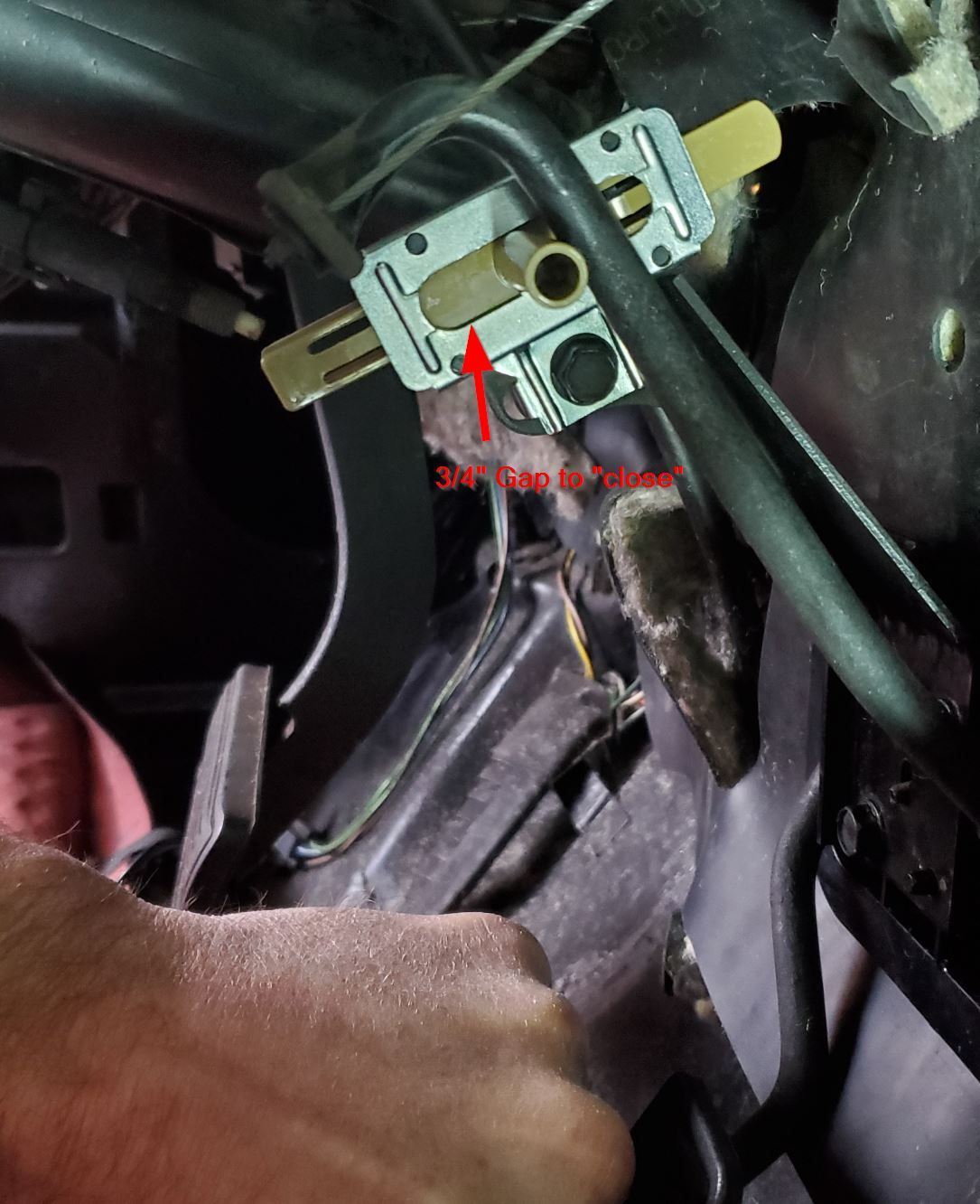

I finally got around to installing my new kickdown switch today. However I ran into a problem. The switch will not activate when the pedal is pressed all the way to the floor. I checked it with a multimeter and the siwtch needs to slide almost 3/4" before it closes the circuit. I know that I don't have the rubber hose on there yet, but that's not going to make up the 3/4" gap. I see no way to make any adjustments to the switch, bracket, or pedal. Do I just hack some sort of block/spacer together? I'm questioning if the switch is the correct version for my car. Even though they physically look the same, maybe the original switch had a different "close" point. Has anyone else had this issue?

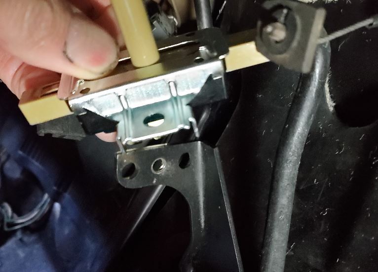

Here's another picture with the pedal at rest. This is installed correctly, right?

There should be three holes in the bracket. Move the switch closer to the rod.

Yes there are 3 holes in the bracket, but only the center one is threaded. The other two holes are intended to accept the tabs on the switch to keep it from rotating:
I could mount the switch on the other side of the bracket and then use a single bolt & nut to secure it. :
Yellowstatue, is this the method you are suggesting? I think it would get me close enough to make it work once I add the rubber hose. I'm not sure if the single bolt/nut would keep it from rotating over time though This is still a hack and I'd prefer to make it "right". Did I buy the wrong switch?

The ST300 and turbo 400 use the same switch. I looked at the assembly manual and saw the three holes thinking they were threaded. Is it possible that the bracket is bent more than necessary? Put the rear tab into the threaded hole to keep it from rotating and a nut and bolt in the front hole for now.

You might try "resetting" the switch. Carefully!! push the tube contact part towards the firewall, push at the base of the tube so you don't snap it off, you'll hear it click & it will stay forward,then the first time you put it to the wood it will set itself.

Success! "Resetting" the switch solved the problem. I didn't realize that the push tube could be moved all the way forward by (gentle) force, but it slid forward just as you said. Thanks rob1960!!
