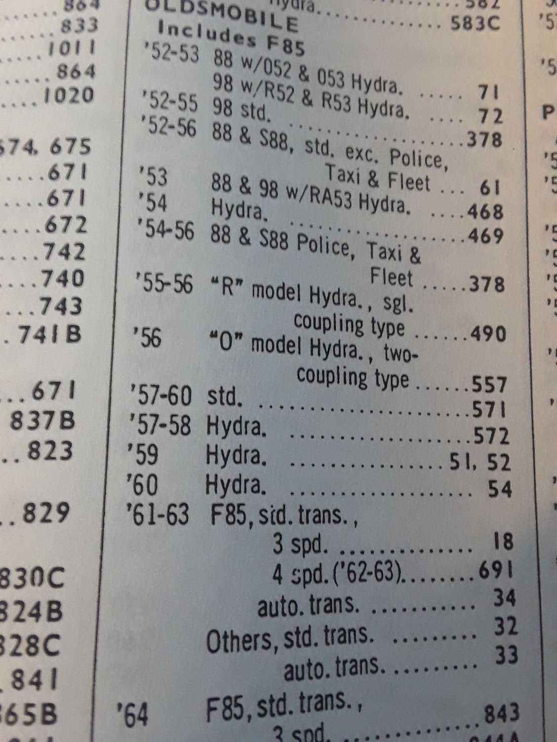

That's a different story.
According to the Hollander there are several other transmissions that will work.
In this list of complete transmissions the one for 1957 Olds is listed as a #572 which fits 57 & 58 Olds

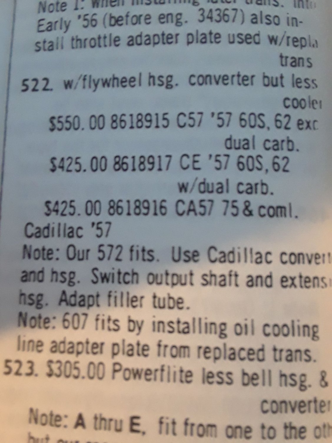

I looked up #572 and found the following notes. # 51, #52, and #54 will fit by using their drive shaft slip yokes, These would be 59 and 60 Oldsmobiles.
They also note that number 522 fits by changing the torque converter and housing and switching the output shaft and housing. That one is for 1957 Cadillac.
As mentioned before, this type of transmission was used by Olds from 56 thru 60. as well as some 56 thru 64 Pontiacs and most 56 thru 64 Cadillacs.
Maybe even some Rolls Royce vehicles too. Many, but not all of the internal parts of those transmissions might interchange.
Good luck.
