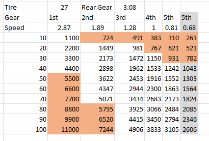

Have you calculated your RPMs in the gears at various speeds? I didn't think the 3.08 I had would be well geared and went with 3.73s based on conversations with the tech at Silver Sport. There are various calculators online, but these are the numbers I came up with based on running 255/60R15's which have a 27 inch diameter. (Speed in MPH)

I was looking at the 3.27, 1.98, 1.34, 1.00 and .72 with the 3.00 reverse. I will check with a calculator but it looks good to me with a 28" tall 275/60R15 tire. Thanks for your input.

Be aware, with a 28" tall tire, 3.08s, and a .72 overdrive, you'll really be struggling to get much use out of 5th gear. You'll be turning 2000 RPM at 75 mph. If that works for you, go for it.

It should work, the 10ish to 1 first gear and the .72 OD gear. Yes, the roller cam is below 220 duration, 218/218, 1600 rpm to 2000 rpm should be about perfect cruise rpm. I ran a 214/214 cam with a 25" tall tire, .68 OD and 2.78 gears. 1500 to 1700 rpm highway cruising, OK mileage and power. I also had Mark do up my RPM for SEFI, should help drivability and mileage.
