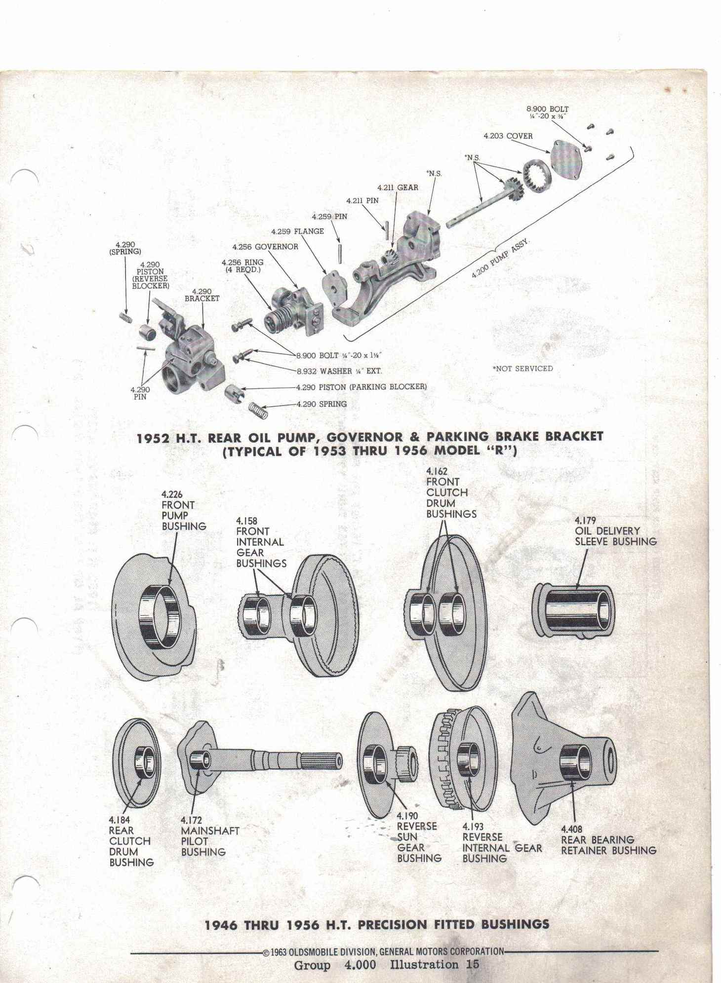

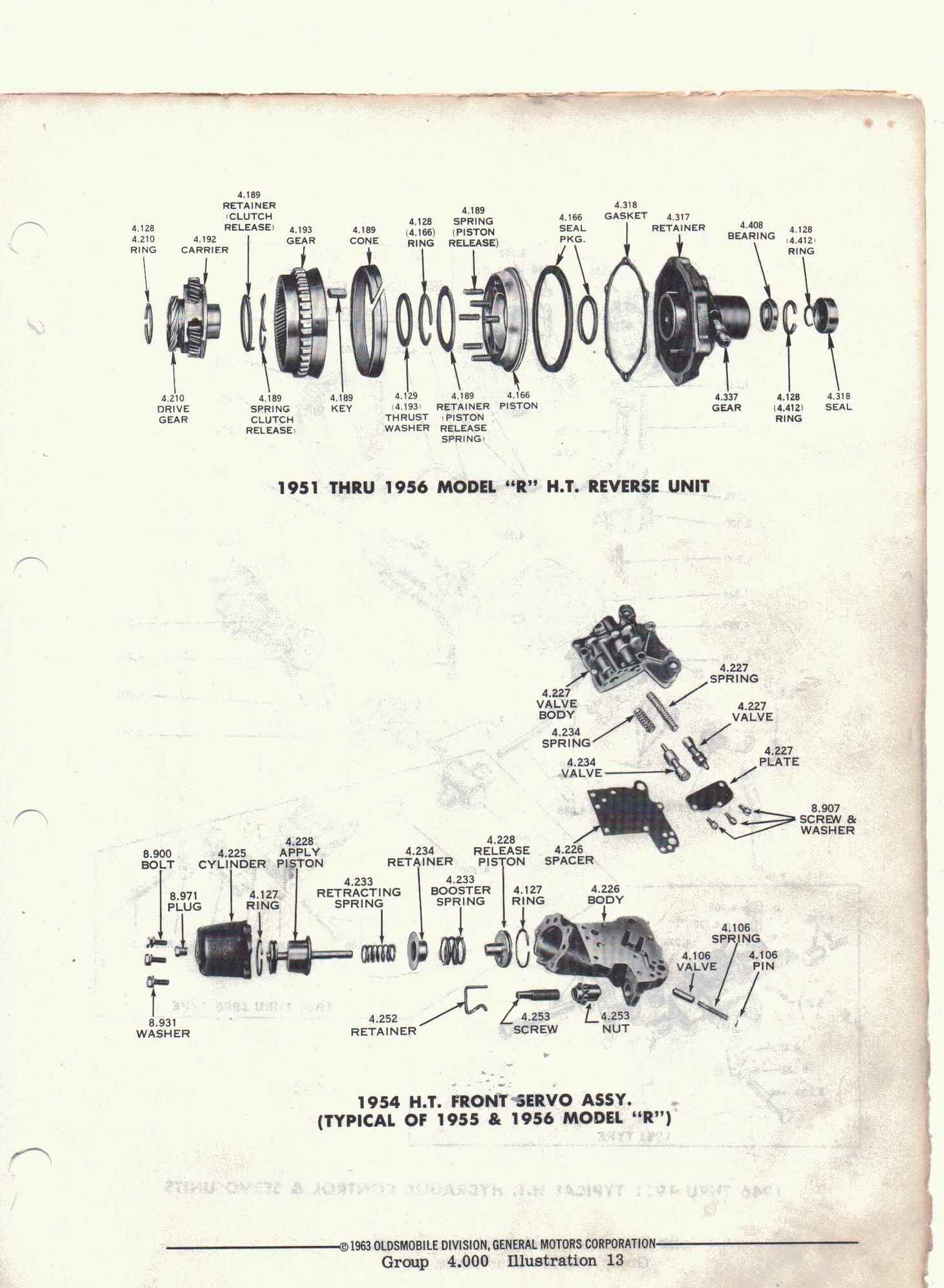

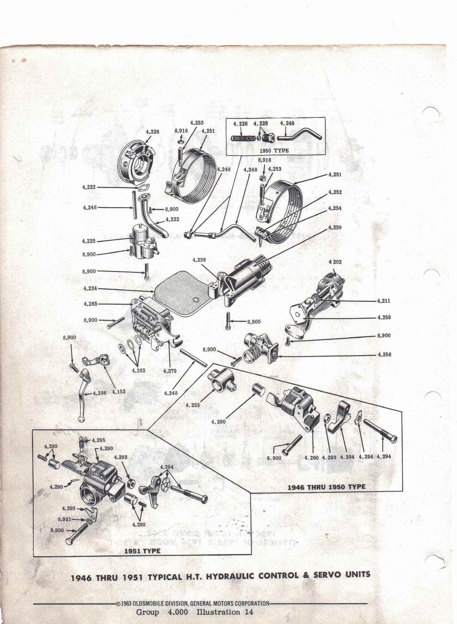

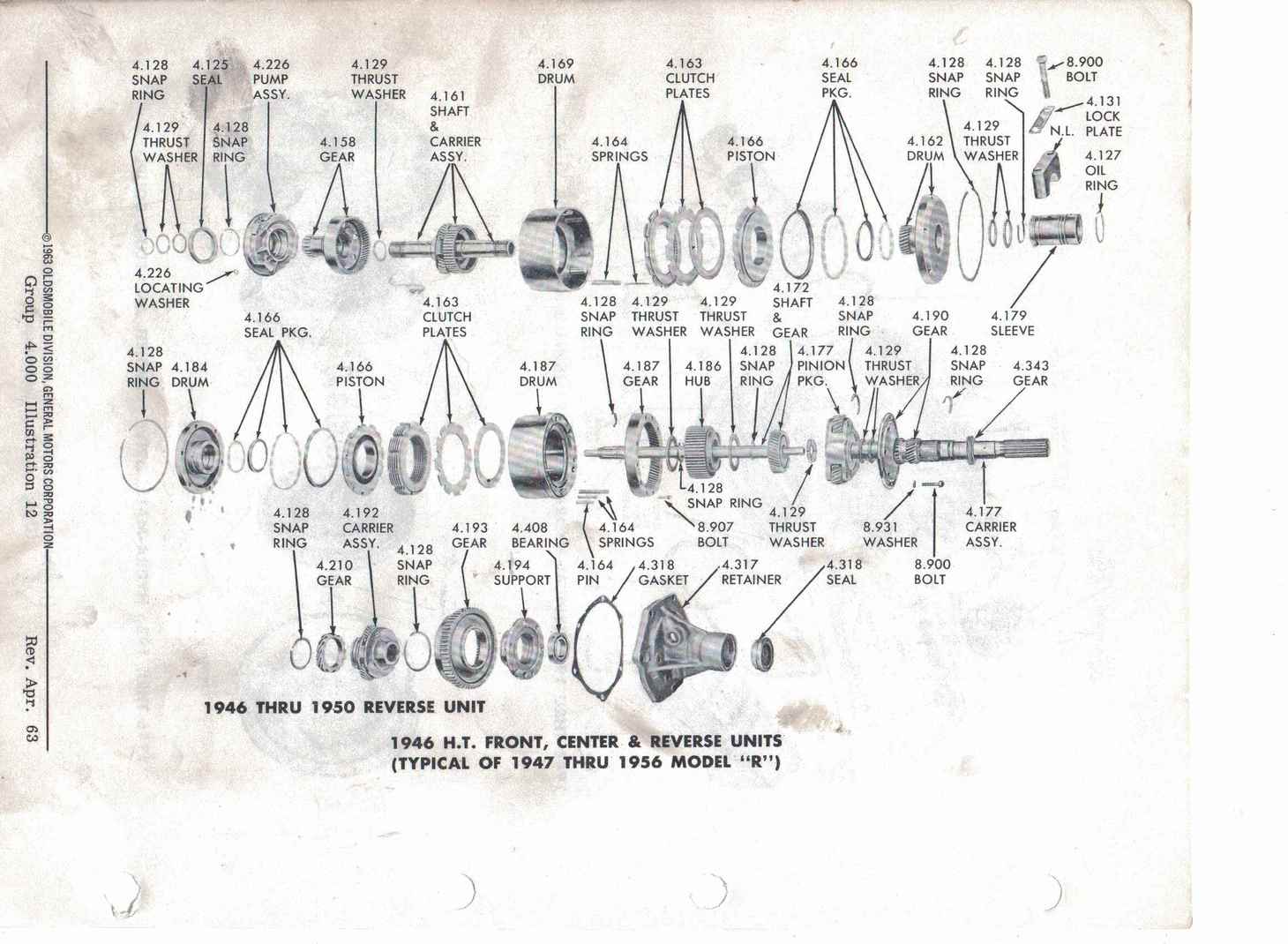

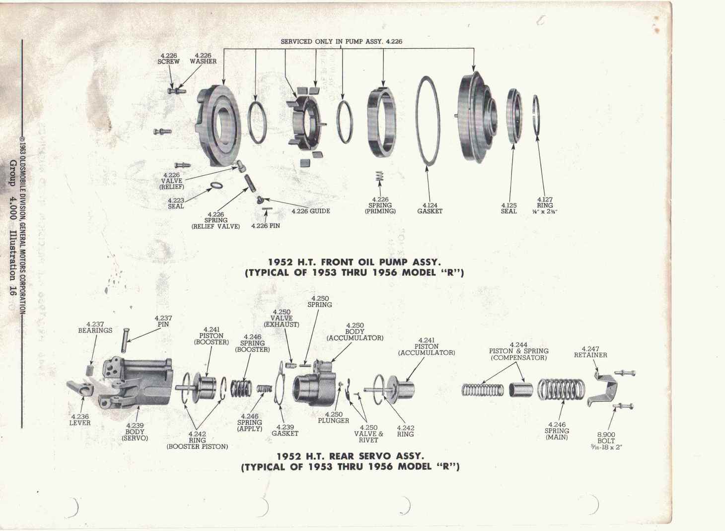

I'm not sure what you are calling a "modulator valve.
Here are a few illustrations of early Hydra-Matic's.
Please tell me the four digit number associated with the part you want.
Then I can give you a part number.
Click on the pictures to make them larger.

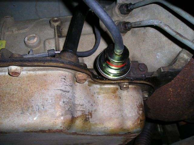

I guess it`s called a vacuum modulator.
the car is in a warehouse.
will have to go look at the car tomorrow.
and check for a part number on car.
could I be wrong and the 1950 hydramatic transmission didn`t have vacuum modulator ?
the transmission is shifting slow and sometimes it has difficulties going from reverse back to drive.
mechanic told me the vacuum modulator might be bad.
so I wanted to buy one before I go to the warehouse.

Find another mechanic.
If he doesn't know that an early Hydra-Matic doesn't have a vacuum modulator, then he doesn't belong working on one.
The first thing I would try is changing the fluid and filter screen.
Use only Dexron III/Mercon fluid.
It should take about 11 quarts to fill if drained completely.
The torus (torque converter) can be drained by two plugs in either side of it.
The 70 year old fluid in it may be gumming up a shift valve.
Pull the pan and change the filter screen too.
The picture that you show is a '65 or up Turbo-Hydramatic 400. That isn't what's in your car is it?

Thanks fellas for all your information. I will drain the fluid and change filter as suggested.
no , that is not the actual transmission in my car. just a picture of a transmission with a vacuum modulator.
