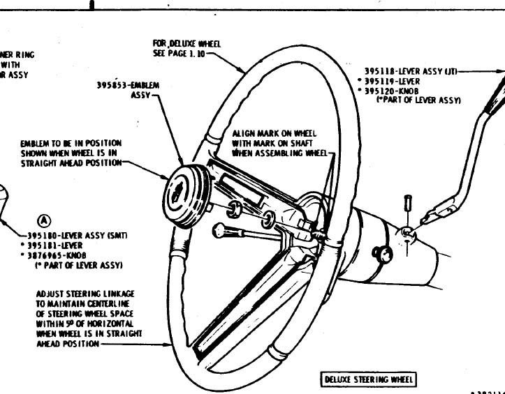

first thing i would do is pull the horn cap and see if the scribe marks on the shaft and wheel line up.

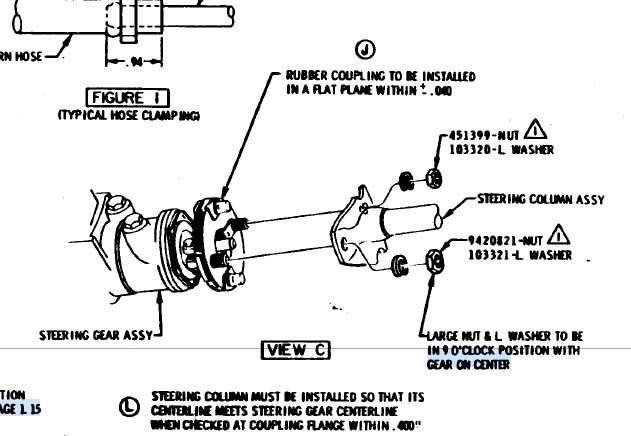

Joe P is right again. Another reason to have the steering gear at the exact center is that there is a high point in the gears for a better on center feel. When you rebuild a box you have set the bearing preload at this point.
As stated if everything is not properly aligned at the top of the column the signals wont cancel properly.
I can't say for the Toronado, but on the F-85 you can start with putting the steering gear in the center by assuring the pitman arm is facing directly rearward. Then install the rag joint and align it like this:
The studs and nuts need to be dead horizontal. Then the notches in the steering wheel will line up properly with the top of the column. After that if the wheel is off center I'd take it to a professional alignment shop.

Actually, the 100% certain way to center the steering box is to accurately count the turns from stop to stop and then come back half way. Note in the drawings above that the fasteners on the rag joint are different sizes - that's why the lockwashers and nuts have different part numbers. As I've regularly pointed out, this hardware only goes together ONE WAY. Yeah, I'm sure some ham-fisted gorilla can assemble it incorrectly. Also note in the second drawing the note about aligning the marks on the shaft and wheel. I still don't understand why people are proud of the fact that they do stuff half-fast.

Per the 1966 SPECS booklet, RPO N33 tilt-only was not available on the 1966 cars. RPO N37 tilt/tele was the only option in model years 1966-68. Glenn's 1969 is the first year that N33 and N37 were both available options. Curiously, N37 Tilt/Tele was available without restriction, but N33 Tilt-only was not available with D55 console. Go figure.
