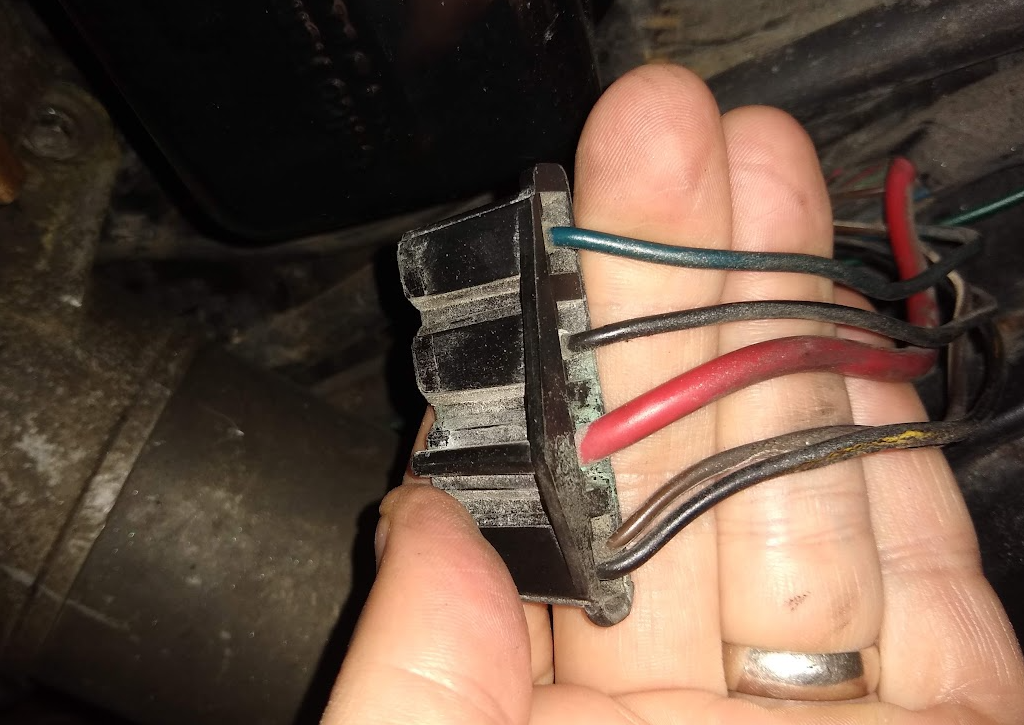

For those interested, I've attached a picture of the shunt splice shown on the 66 schematic. I removed the background for clarity and tried to save it as a jpg so it would display in the post. For some reason, it kept saving as a pdf even though I selected the jpg export option. Go figure. Anyway, the splice was located in the main bundle that runs along the firewall. I cannot be more specific because I removed the bundle from the car. Looking at the schematic, there is a small text block in the lower right corner that indicates a default wire size. I cannot get clarity to tell for sure, but I would assess the default wire size is 16 ga. The text looks like it could be 16 or 18, and I think 18 is too small. Can anyone verify the default wire size? Thanks.

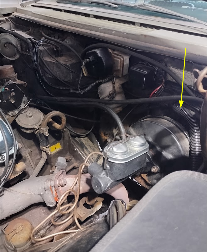

So, you mean you found it in the engine bay side of the firewall? It appears to be one large wire on one side of the splice with several on the other......do I have that right? I would imagine that the large red wires going into that splice are more like 10 gauge. I know the wiring diagram says something about the default wire gauge being 16 or 18 gauge or something like that but not here. The red wire coming off the alternator goes to that shunt splice and I reckon it's a 10 gauge, maybe 12.
In any case, this is really good info thank you so much for posting it.
In this area somewhere? Yeah, mine is covered in loom currently.....I will fix it at some point.

Yes, it was on the engine bay side, but cannot say for certain where, as I didn't find the shunt until I pulled the bundle out of the car. I would guess it's not too far from where you indicate. The way it is spliced together from what I can tell is that all the red wires in the engine bay are on the same side of the splice as the large feed wire from the alternator. All the red wires going into the cabin are on the other side. That's the way is seems to me but I can send ore pictures from different vantages if that would help.

That's awesome! Yes if you could get a few more snaps of the shunt splice maybe we can identify which wires go where. Whenever you get a chance, thanks again! Excellent work.

I pulled apart the bundle at the splice connection and measured the wire sizes. Here are the results:
All wires in the bundle passing through the fire wall (not counting the separate signal and headlight bundle) are 18 ga except for the following:
The large purple wire is 14 ga
The brown and white wire in my bundle was a solid wire about 24 ga
Green wire was 20 ga
Red wire to lights was 14 ga
Red wire to ignition was 12 ga
The shunt splice presents a little bit of a mystery when compared against the schematic. The schematic shows six wires at the shunt, but the picture shows seven; and there is black wire when the picture shows none. I think I have an explanation for both of these. The four wires on one side of the shunt go to the fuse bus, the ignition switch, the light switch, and the amp meter. On the schematic, that wire is black, but I had to remove a red wire from a gauge cluster plug to get the bundle out. The schematic shows no other red wires going to the gauge cluster plugs. Second, there is another splice shown on the alternator wire that goes to the regulator. I believe the small wire on the three wire side of the splice goes to the regulator, unless someone knows this would cause a problem with voltage regulation by moving that splice on the schematic to the shunt.

Originally Posted by MajD
Everyone,
Once again I was not able to convert the picture to a jpeg. Apologies.
MajD
Awesome! Yes, you are correct about that black wire going to the ammeter. On my car it's red, rather than black. Obviously an error in the diagram (yet another one).
With regards to the regulator wire.......interesting. On my car, the red regulator wire is rather large. It shouldn't be one of the small wires going to the splice. It definitely goes to the splice according to the diagram but it's a thick gauge wire. I'll post some pics of mine:
Red wire and black/white wire are the ammeter wires.
Large red wire on the regulator.

I really apreciate you taking the photo for us here, but can anyone else see any color in that photo? I have a bit of a color deficiency with my vision but it seems to me that there's no color in those wires? I can't make anything out at all.
