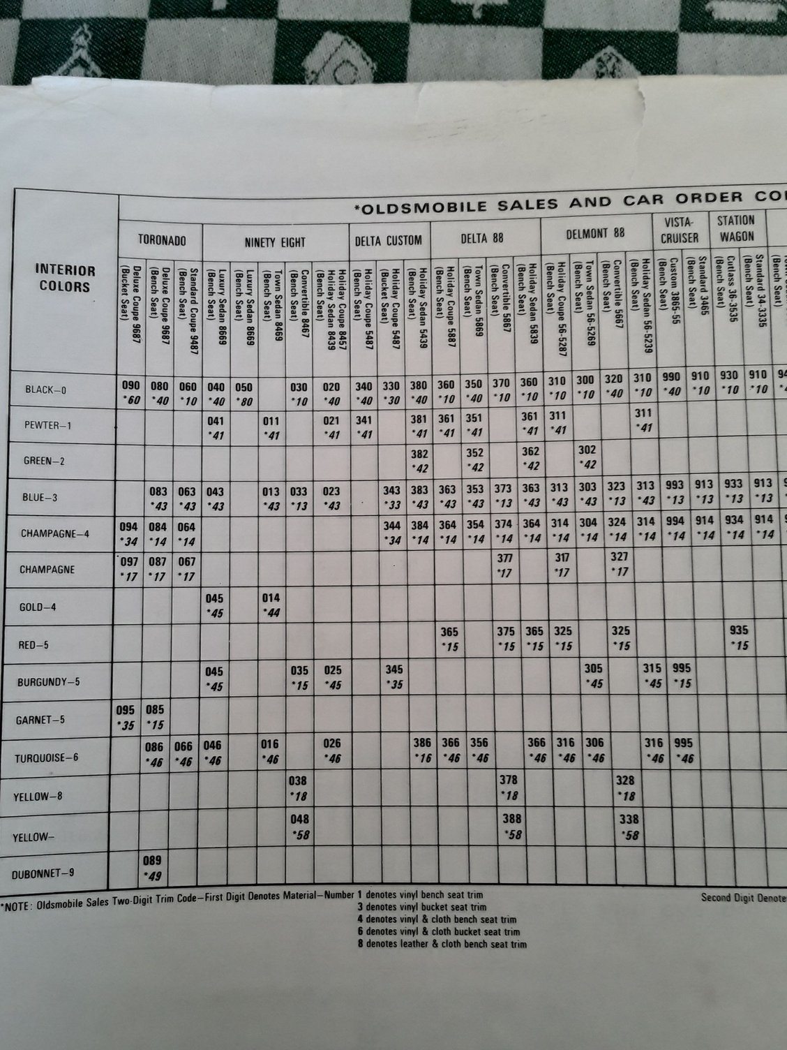

I found some additional info in the build manual posted
on this site, regarding the seats trim code 095 appears to be dark red color

Looks correct!

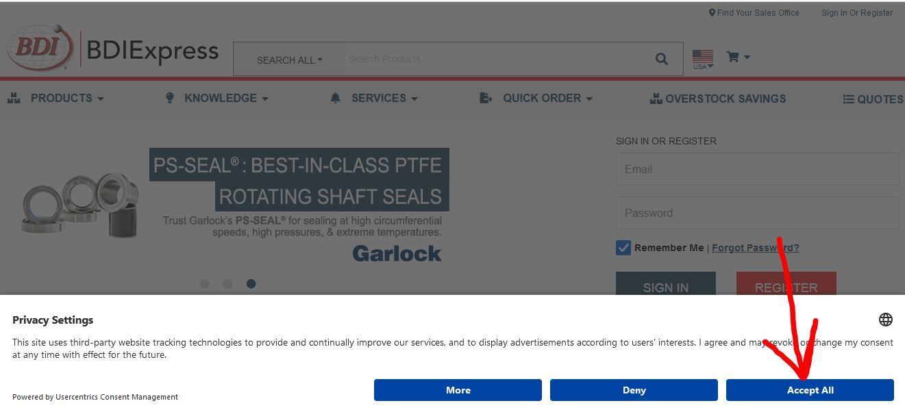

If needed BDI is who you want to contact for new bearings/races seals. Dont expect to find anything but chinese junk at the big box parts houses. DO expect bearing failure in short order if that's the route you are thinking of going in.
Before calling BDI Have your part numbers ready to go. Insist on USA made or anything other than china. For some reason chineasium is the first thing they will try to sell you when for a few dollars more you can get a bearing or seal you can trust. Swiss, Japan, German, Canadian even Mexican is better quality/durability. Use the right grease too.
https://www.bdiexpress.com/us/en/
Click accept all at the bottom right when the site opens(this is new)

This is from Nov 73 factory body parts book.
Garnet vinyl available for both Strato-bench and Strato-bucket interiors ONLY on 9687. N/A for 9487.
