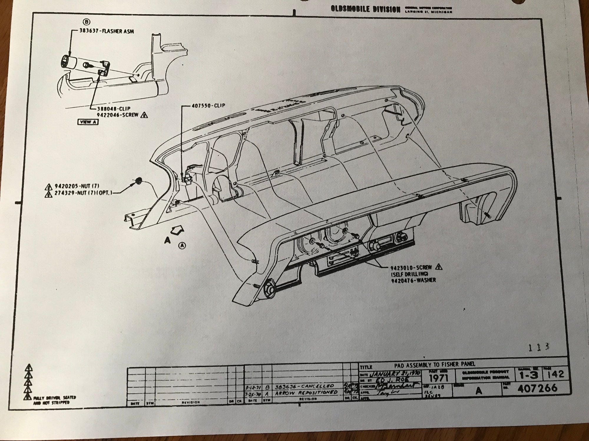

Were do i go hunting for the Turn Signal FLASHER on a '71 442 ?
Hoping thats my problem. When i activate the Turn Signal the Brake Lt goes out on that side and NO Turn Light.

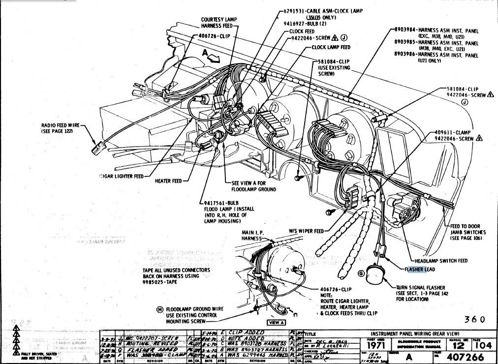

It's located on the left-hand side of the dash just to the right of the headlamp switch towards the steering column. It's tucked into a holder which is mounted on the lower edge of the dash - hard to see without getting your head under the dash. You can feel it but better to get a flashlight with your head looking upwards from the floor - or use a mirror. I'll see if I can post a diagram.
