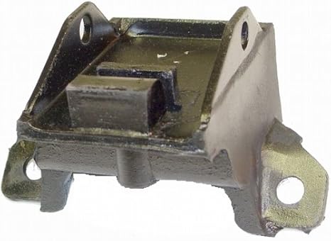

Joe what's your take on these i bought them for my 69 and they are USA made but do you think they are the correct height etc?

Mystery motor mounts (to me anyway!)
I purchased a 455 core engine from Craigslist and it had these bolted to the block. I was guessing they were for the clamshell rubber mounts, but the funny bends in the top don't really look right. I don't need them but until I know the application I won't be able to offer them up for sale. Joe, or anybody else recognize these? John

Yeah, they USED to look like this:
Those are part of the 403 Trans Am mounts. They are missing the bar that spans the three Olds motor mount bolt holes. Apparently some ham-fisted P.O. beat them into submission without the proper mounting hardware.
The complete T/A mount looks like this:
Old Aug 31, 2014 | 01:20 PM

Thanks Joe
I was thinking the funny shape on top was factory. But your photos make it clear that they're not suppose to be shaped that way!
John

Posts: 7
'70-'72 F-85 w/455 engine mounts
The problem I see with aftermarket engine mounts, is they are simply not correct for the A-body with the 455. The common Anchor A2328 mount is correct for the 88 and 98, not for the A-body. The parts book says P/N 406436 for the F-85, '69 w/400, and '70-'72 w/455, and P/N 417137 for the '71 on 88 and 98. As far as I can tell the A2328 is a match to the 417137 which is used on many applications. The 406436 is unique to the 69 to 72 big block F-85. I attached a photo of the two mounts side by side. The one with the red stripe is correct for the F-85 which I purchased in the late 70's, and the other is the current aftermarket. Notice the location of the side hole which bolts to the chassis mount.
When I attempted to use the aftermarket, the engine sits high, the fan blades hits the shroud, and if I try to close the hood it will crush the OAI on my '71 W-30. Not good.
Why don't the Fusicks and Supercars recognize this and reproduce the correct mount. It is the same as the A2328, but the side hole need to be relocated.
I have taken the aftermarket, plugged and welded the holes shut, re-drilled them in the proper location, and have been using them without problems for years now.
But it would be far better, if they were properly reproduced.
