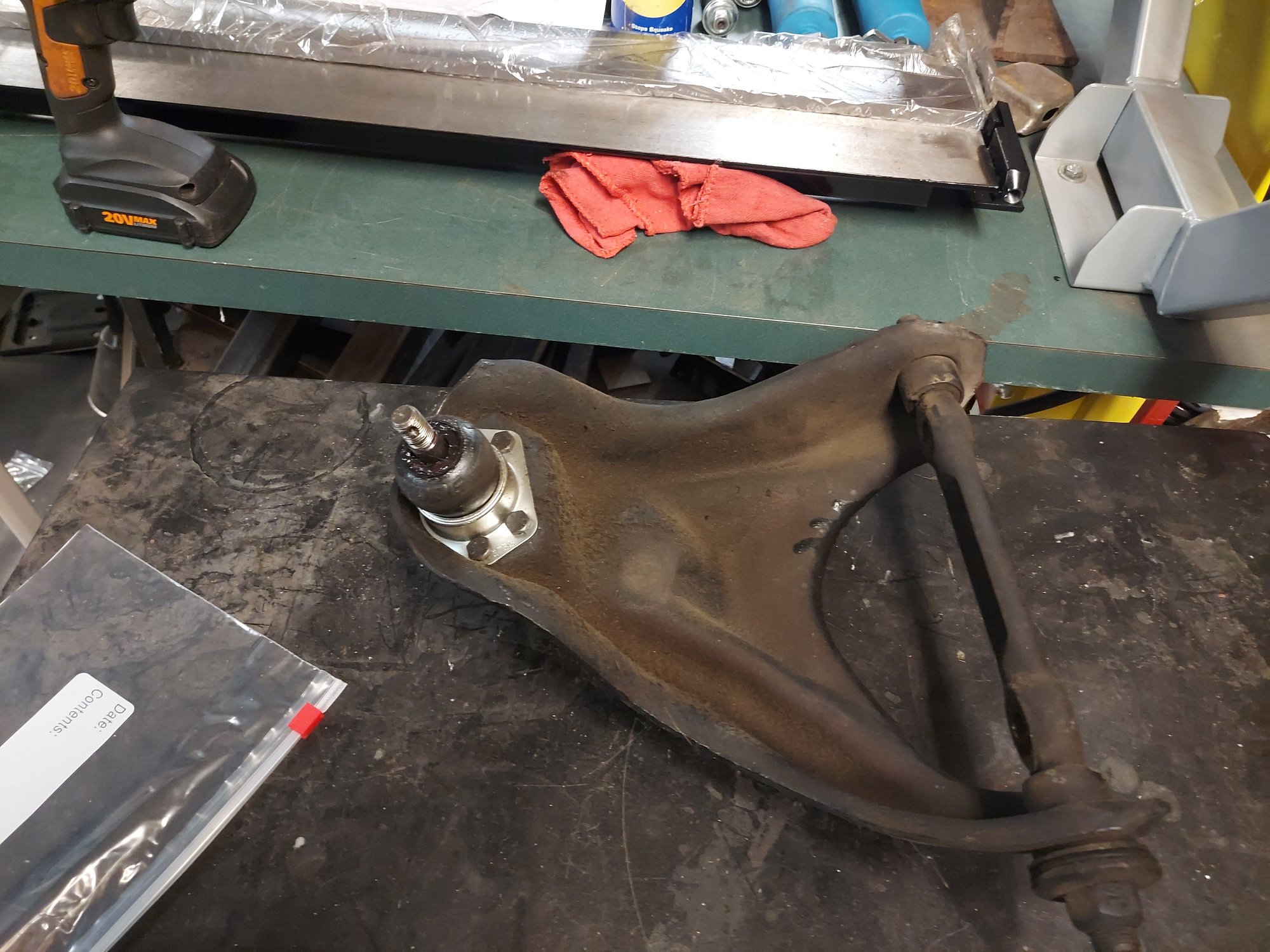

Picked up some used parts with a new ball joint.
Like the title says "What's wrong with this picture"

It would be good if the ball joint was on the correct side of the control arm. Lol.
It's just the steel plate that's on the wrong side.
I was putting it together "The same way it came off" and something just didn't seem right.
Also shouldn't the bolts come down from the top, in the rare case the nut comes off at least the bolt won't fall out?

Yeah, that's just the retainer for the dust boot, not the flange for the ball joint. I usually put the nuts on top, to avoid any clearance issues between the bolts and the spindle. If a nut comes off, you have a bigger problem anyway. After a couple of bumps, the bolt is coming out no matter which way you installed it.

Were the ball joints bolted or riveted from the factory?
Old Apr 12, 2021 | 07:39 AM
Posts: 26,066
I believe that’s a 1970 control arm and I believe all the A-Body vehicles were riveted. But, you know what, as soon as I make the statement Curmudgeon will hit me with a smack-down. Maybe I’ll get lucky this time!
Old Apr 12, 2021 | 08:00 AM
Posts: 50,806
Eventually even a blind squirrel finds a nut...
Yes, the were riveted from the factory.
