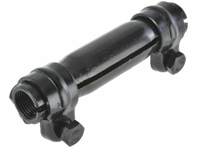

Friends, I have a request for advice. 1966 Olds Delta 88, I am trying to align the steering, the geometry of the front axle, I aligned the steering wheel (the factory marking of the centering under the cover is correct, I adjusted the steering rods on the driver's side (toe-in - 2 mm)on the passenger side, but I can't turn the steering rod = the screw on the engine side is tight, I cleaned it, applied WD40 release agent, tapped it lightly with two hammers = nothing I need to screw the rod at the steering ball joint (at the wheel) more (I have more toe-in on the passenger side) should I remove the wheel stud or do you have any ideas how to loosen the adjustment? Thanks

Do you have a tie rod adjusting wrench? I have one similar to this. The points fit into the slot in the adjusting sleeve. There are multiple possible orientations to avoid obstructions. I find that spraying penetrating oil into the slot ahead of time makes a big difference.

You may want to try spreading the clamp and or the sleeve.
You only need a millimeter or two. I use a square shanked large flat blade screw driver with an open end wrench to twist.
Two pipe wrenches will suffice like Eric mentions, unless you can source the tool tool Joe shows.
WD40 is not the best penetrant for breaking rust, Kroil, PB Blaster, Castles "Thrust" are designed for this purpose.

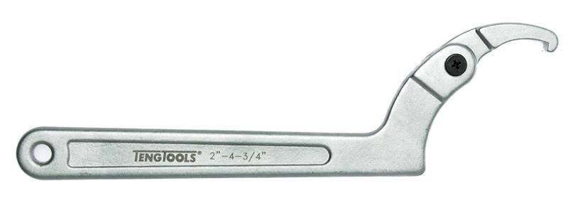

I use wd40 specialized penetrant, I would have to order a special tool like Joe wrote, it is not used much here in Europe, but I can try this one (photo)

Not the correct tool. It will slip off the sleeve when you start to put any serious force on it. Note that the handle even says that it is for nuts in the 2" to 4.75" range. Your tie rod sleeve is about 3/4".

I replaced tie rod ends with new MOOG ES314RL, I also replaced the new sleeves, treated the threads with copper paste and adjusted the toe-in, is it currently 5/16 inches okay, or should I set it to 3/16 inches? I don't know if the MOOG ball joints are already lubricated from the factory, or should I apply NLGI 2 type lubricant?
