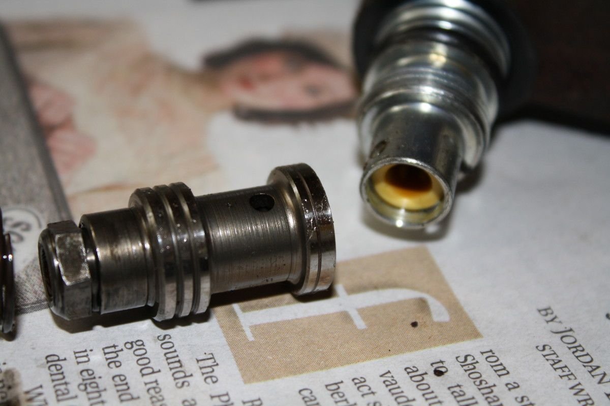

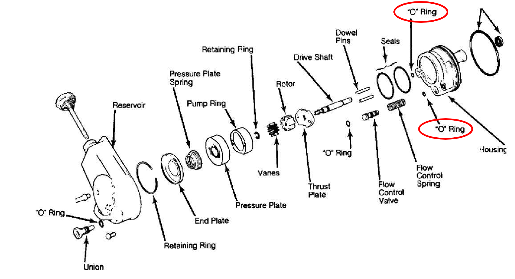

Unfortunately it could be a lot of things. The reservoir on the Saginaw pump is retained by the pressure fitting and two bolts that pass through the reservoir. There are square cross section O-rings between the inside of the reservoir and the pump body at these bolts and the fitting. Check for loose fasteners. Yeah, it can also be the shaft seal at the front. The reduced power assist may be a loose nut on the pressure control valve inside the outlet port.
