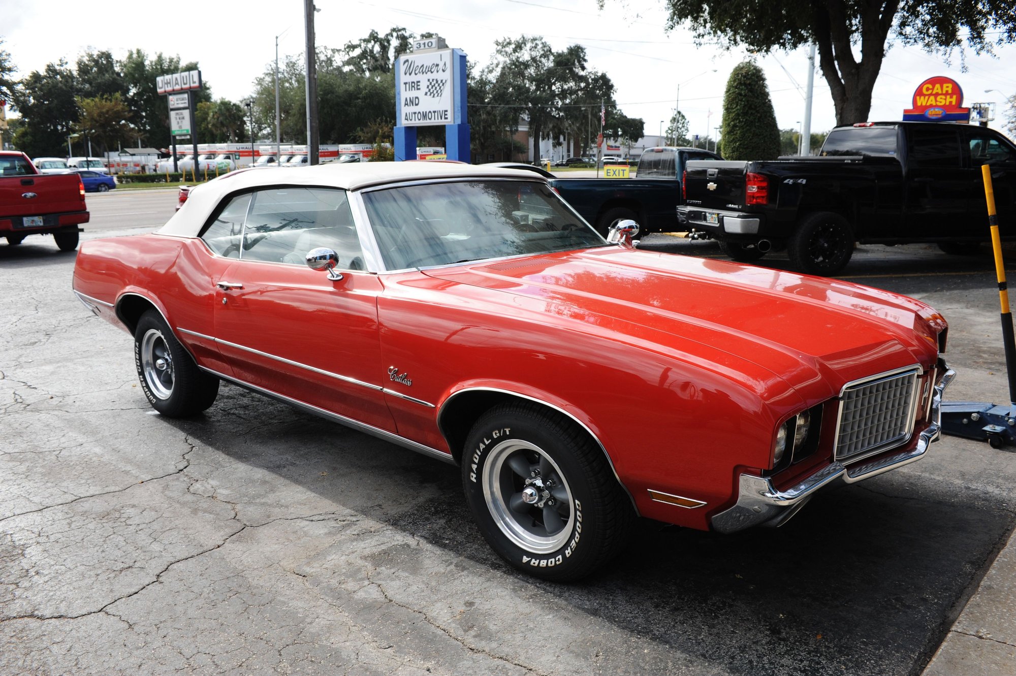

My car sits relatively low, a look that alot of people go for. However, im looking to get a raked look and somewhat slightly lifted. I have no knowledge of how to go about the look I am trying to achieve. I want to maintain the stock 14" wheels but raise the height a bit. is there a spring/shock set up i should look into that would help me achieve the look/stance I am going for? Do i need springs to or just taller shocks? below is a picture of the stance/height of the car I would like to achieve and my car as it sits now.

Shocks do not support the car, they work as dampers. Springs support. Could you post a side view of your car.
Old Mar 3, 2019 | 01:14 PM
Posts: 50,768
^^^This. The photos of both cars need to be at the same angle to make a meaningful comparison. Personally, the front of the blue car is too high for my tastes. Looks like the engine is out of it. Most modern 14" tires will be noticeably smaller in diameter than the original tires on your car, and raising it will accentuate the daylight in the wheelwells.

Much better picture. Looking at your car it seems to be at the right height, if not a bit higher than stock in the rear. I think your problem is the diameter of your tires is a bit small.

Im trying to go for a raked look with skinnier tires in the front and taller ones in the rear. Not sure what tire size would achieve this look for front/rear. I am open to getting new tires as the ones on the car are at about 50%. I just also noted that the white lettering on the tire is on the inside, meaning the tires were installed on the wheels with the lettering facing towards the car...

1in drop springs / same as the 40 year old sagging ones

The ride height on your car is nice, but i was hoping to raise the rear a bit for a more raked look. Any advice guys?

If your looking to raise the car like in the very beginning of the video, I'd install big block springs in the front first. The rear looks plenty high at the moment.

Any Idea what part number I should be looking for? I believe MOOG is the brand. Im willing to buy the tallest rear springs too and swap them out. Any idea for part numbers? all help is appreciated!

I installed Moog 5415 springs in the back of my '72 Cutlass ragtop and they gave it about a 3-4" lift above stock height - I'm running 245-60-15 tires all around so the total height would be slightly higher than you'd get with a 14" tire of otherwise similar dimensions.- stock 5536 springs up front (350 a/c car)
