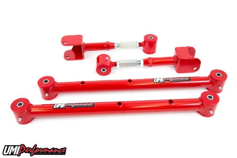

I'm new here in the forum. I'm from Germany and I'm restoring my '67 Delta 88 holiday coupe. I'd like to replace the rear upper and lower control arms and I'm not sure which ones to go with. I asked UMI Performance and this kit was suggested to me.
https://www.umiperformance.com/home/product/1964-1967-gm-a-body-tubular-lower-adjustable-upper-rear-control-arms-kit/
before that I had measured my control arms and the picture sent to them. But my body is actually a B body i think. Does anyone have a tip for me which I can use?
Thanks René

Your car is not an A-body, it is a B-body. No one makes aftermarket suspension parts for the 65-70 Olds full size cars. A-body parts do not fit (except for the rear lower control arms). No, Impala parts do not fit either. Whoever you spoke to at UMI is clueless, as are most aftermarket vendors when it comes to Oldsmobile parts.
But then why do they also offer it on their site for B Body?
https://www.umiperformance.com/home/...ar-suspension/
Old Feb 6, 2022 | 07:35 AM
Posts: 50,802
One more time:
Have you even looked at their lower control arms? Do these look like yours? Hint: the Impala chassis, suspension, and brakes are COMPLETELY different from the ones on Olds full size cars. NOTHING interchanges.

That is the point. That's why I asked Umi. I'm not stupid and I see that they look different and I didn't just order blindly. And based on my measurements that I had given, the Umi employee suggested the kit for the A-Body.
And since I'm still not really convinced, I'm asking here if anyone has experience. I can't just send wrong parts back to America. that's way too expensive. So it has to be safe

Instead of asking an aftermarket supplier, who assumes that Chevy = all of GM, I suggest you refer to the factory-published parts book. As I pointed out above, the rear lower control arms on the 65-70 Oldsmobile B-body cars have the same part number as those on the 64-67 A-body cars. That means that the Cutlass/Chevelle rear lower control arms DO work on your Delta. The Impala arms will not. Note that the Impala arms have pads for the rear coil springs. Yours do not because the suspension geometry is completely different. The Impala uses a three link rear suspension with a separate Panhard rod. The Delta uses a conventional angled four link. But hey, your money, do what you what.

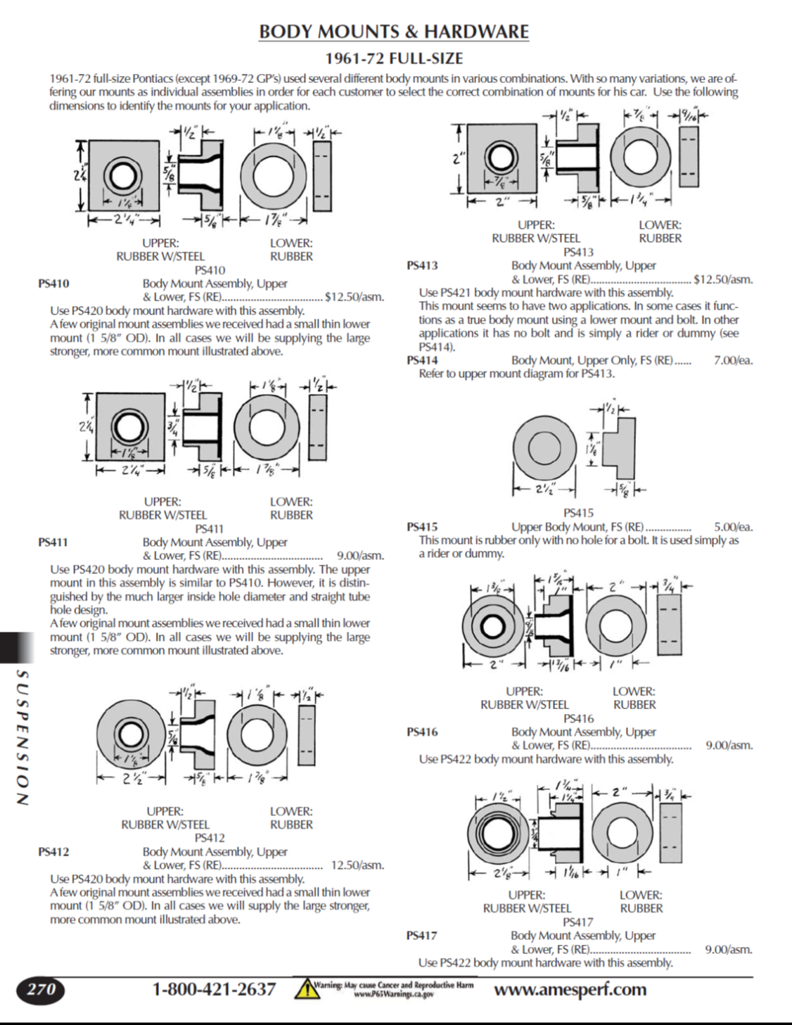

could you help me with another problem? I am urgently looking for body mounts. I really can't find anything. Are there alternatives that can be used?

Old Feb 6, 2022 | 10:47 AM
Posts: 50,802
The Olds full size cars are not popular to restore, so few vendors sell parts specifically for them. While SOME parts are common with those on other GM cars, many are not. This is not a car you can build out of a catalog. Even many of the Olds specialty vendors get parts applications wrong for these cars. You won't find a body mount kit for these cars, for example. Ames Performance DOES list the sizes of individual body mounts in their Pontiac Full Size catalog. Your best bet is to match these up with your old ones. Also, the core support bushings for the 1973-77 A-body cars that Fusick sells are just about identical to the ones I took off of my 67 Delta.

There seems to be an issue of misunderstanding in this thread. The link posted by Rino in the first post is not a link to UMI impala control arms, but 64-67 UMI A-body rear control arms. Before going off about how much UMI does not know, look at what they recommended. The question was not about front control arms which no one makes. The lower rear control arms interchange between 64-67 A-body and Rino's car. What is the difference between the A-body upper rear control arms and the delta rear control arms? I ask because I do not know. If it is an issue of length, the upper arms in the UMI kit are adjustable so they will probably work (most likely the reason UMI suggested this kit). The lower arms in the link in post 1 WILL work on Rino's car. If you call UMI again, they will be able to tell you the maximum and minimum lengths that the upper bars can be adjusted to. If they can be adjusted to the length of your upper bars then UMI is correct the kit will work. If the upper A-body arms and delta arms are completely different, you can still buy the lower A-body arms. BTW, these are the bars UMI suggested (link in the first post), not the impala bars referenced later in this thread.
Which is what I said in Post #4 above:

I realize this, but you spent the rest of the thread saying that UMI has no idea what they are talking about and what they suggested will not work. What is the difference between the upper A-body arms and the delta arms? Is it just the length?
