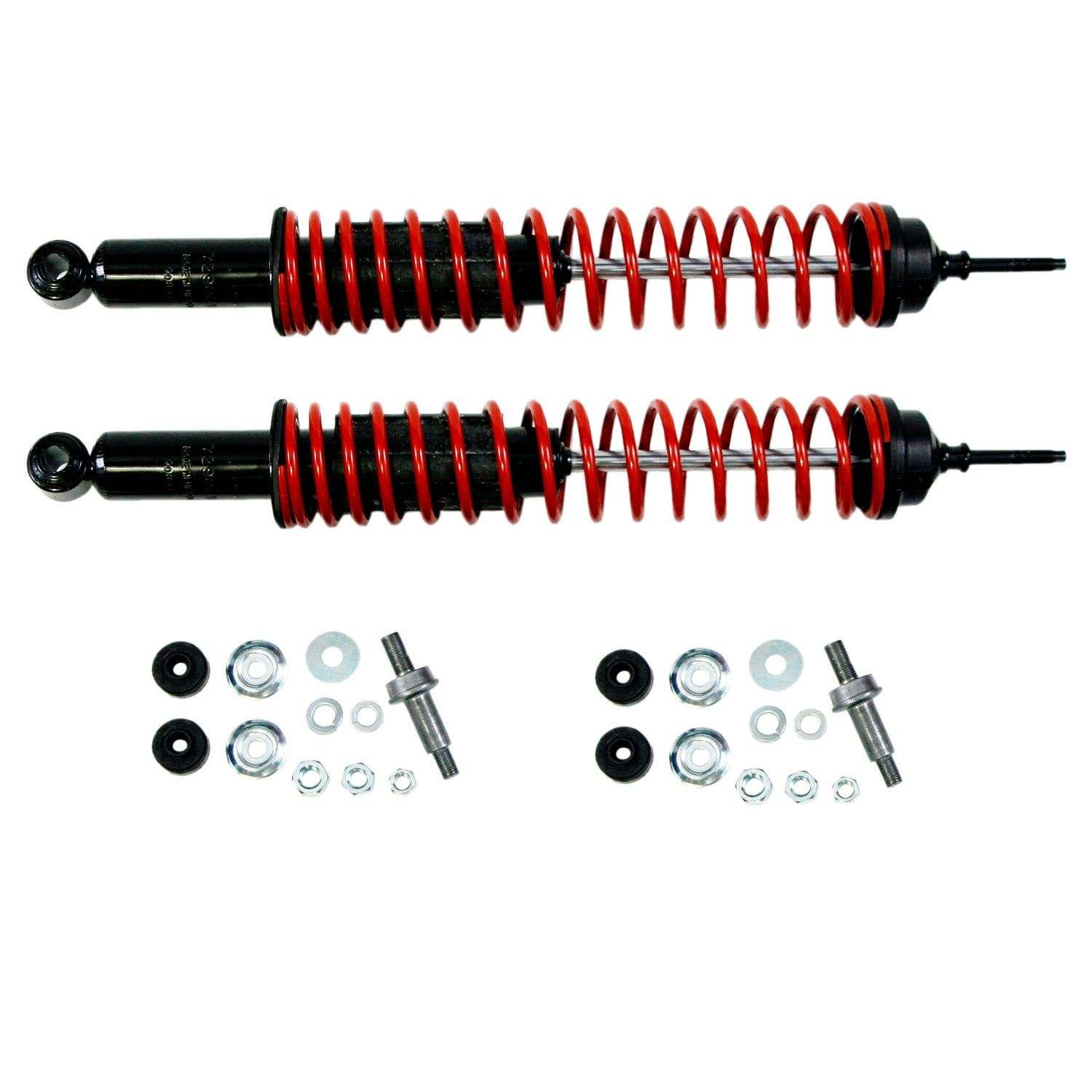

You can get rear shocks with overload springs, which are not the same as coilovers. They used to be popular for towing.

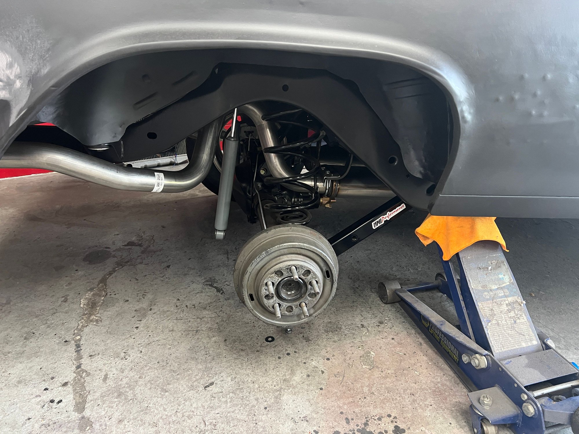

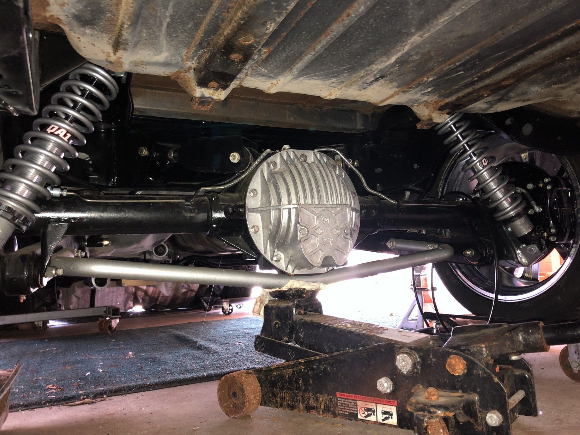

I have a 66 with QA1 front coil overs/shocks, UMI springs and QA1 shocks in the back. Rides and handles really well and dead hooks on the track. Easy to do, the hard part is installing new coil springs in the front. If you use coil overs, that is eliminated.

have install QA1 coil over / shocks on the front and rear of my 1970 added tubular upper A-arms in the front as well. Benefits ride adjustment and multiple spring options.

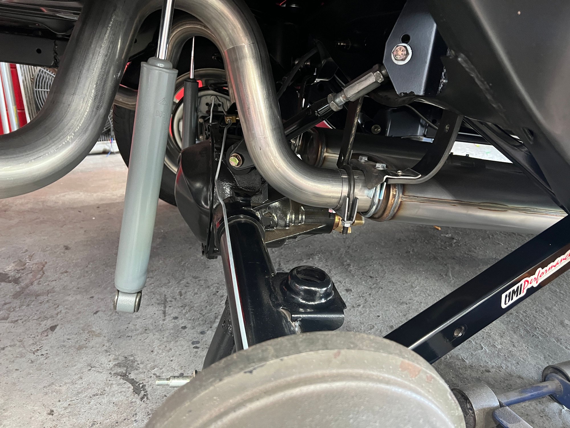

On my 67, I went with Moog HD rear springs, "overload" shocks, UMI sway bar and McBay Performance 1" lift billet spring spacers to get the stance and I ride that I enjoy.
