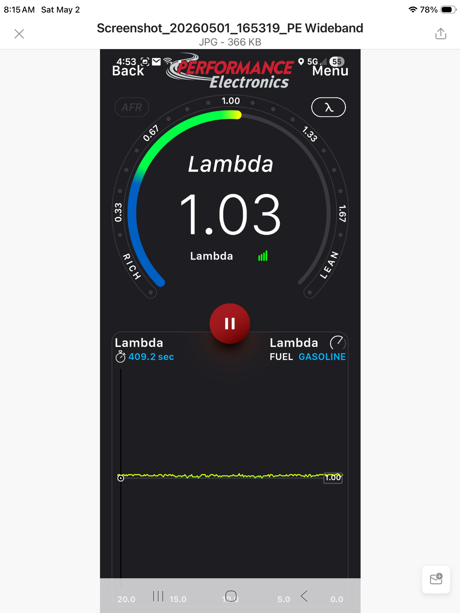

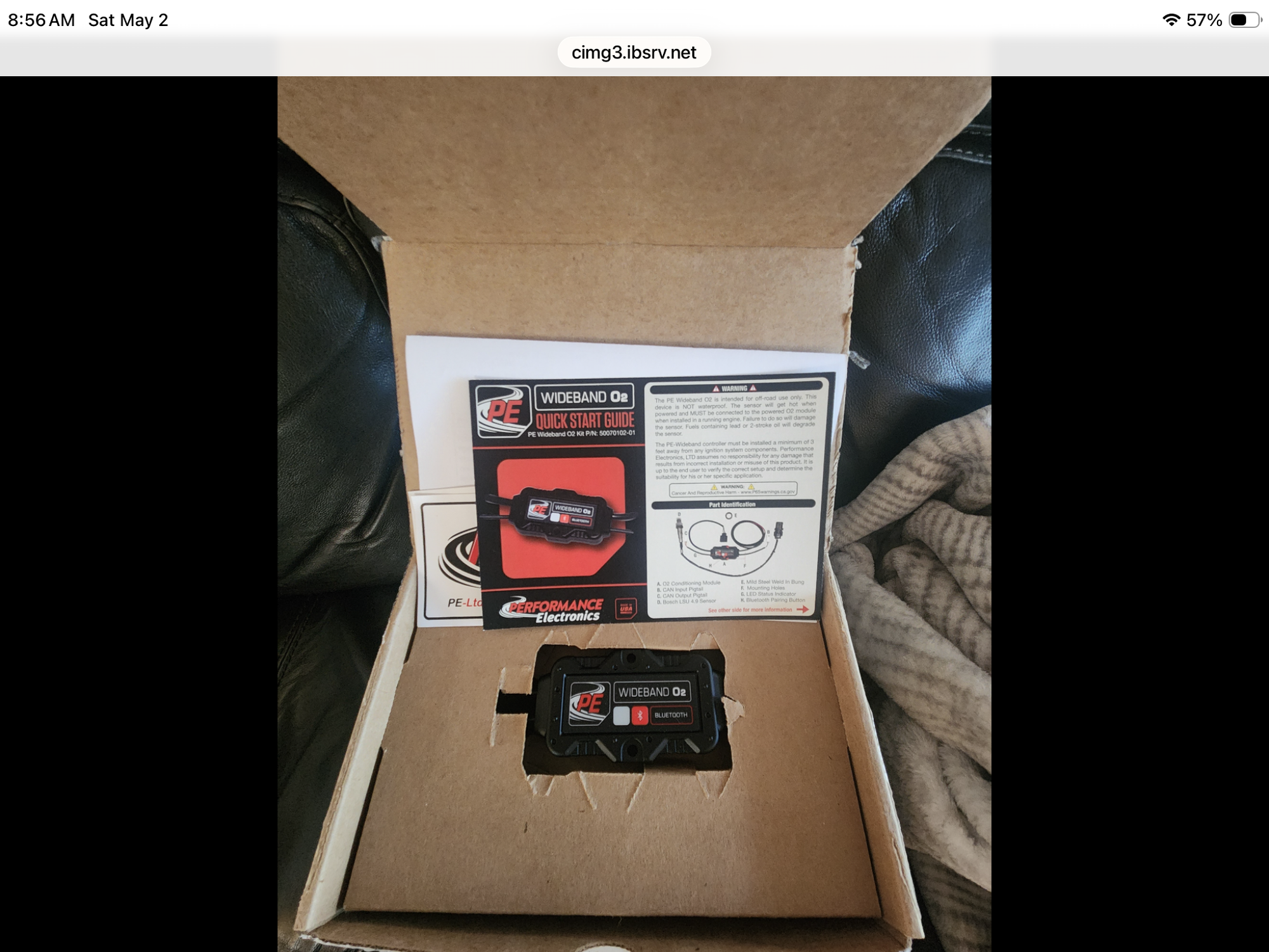

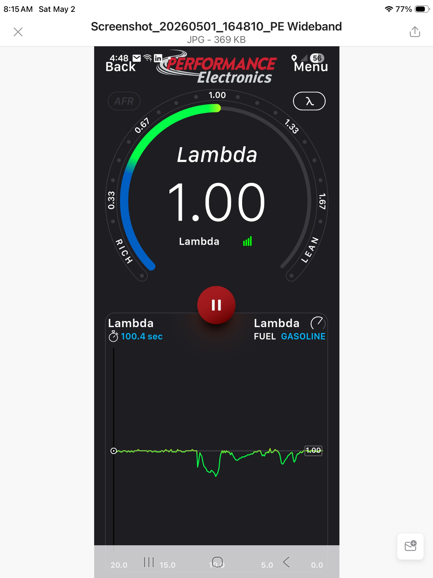

I found this PE wideband, originally wanted the PLX but couldn’t find one.
Really glad I have a wideband now, help greatly with getting carb data.
this PE works like the PLX and transmits data to phone so no permanent instal required.
i had a bung put in each down-pipe. The unit just needs a positive and negative and install the O2 sensor and bang…in business…
I simply zip tied the unit to the brake booster area for temp use and put an end on that plugged into the hood light power wire and put ground on firewall. To operate I just turn parking lights on for power.
