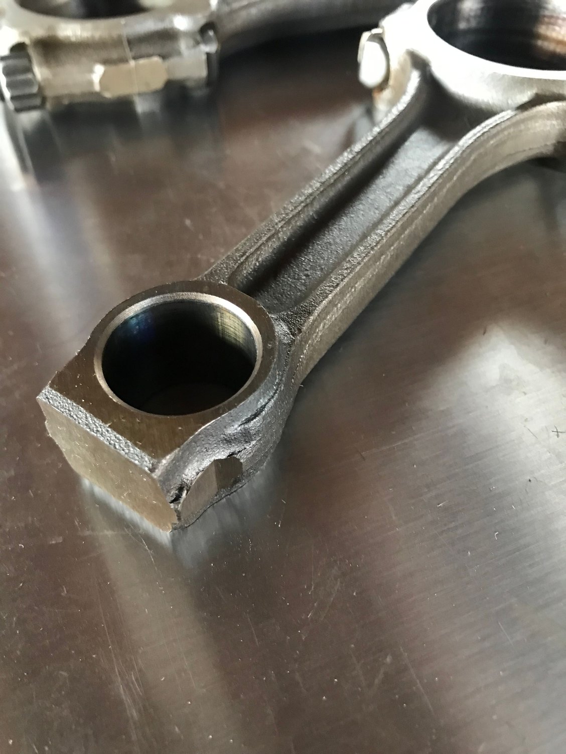

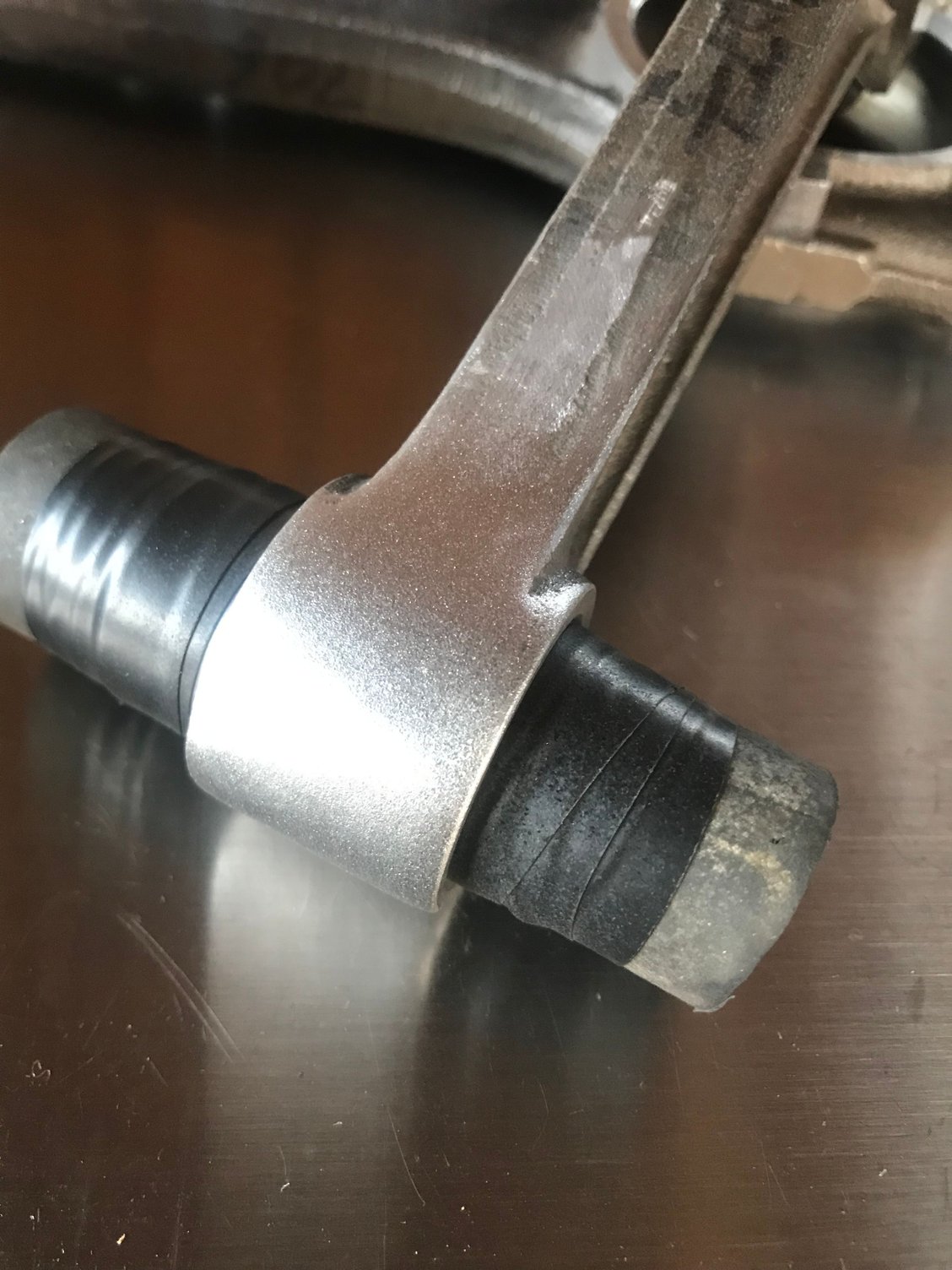

it’s rare that I need to do anything to a factory damper (never) or flywheel/flexplate (sometimes)….on a stock type build externally balanced build.
Sometimes the flywheel/flex plate does need a touch up only because it’s easier to do if the crank counterweight can’t do it on that end.
here’s an example. I just did a mild low budget 350 using all factory parts…but they are heavier…yet didn’t have to do anything to the stock damper and flexplate
went from 350 to 403 rods…they’re heavier on big and small end.
i went with factory nos 4.125” small dish Toronado pistons from a big dish low comp one..so we gained weight there. It’s easy to trim the 403 rods to stock 350 rod weight on the small end to also take in to account the heavier piston.
then lighten the big end to match the 350 rod..that’s it., done. It’s now the same as it left the factory. Didn’t have to touch the crank, flywheel or damper. Here’s the 403 rod small end lightened and shot peened …before and after
