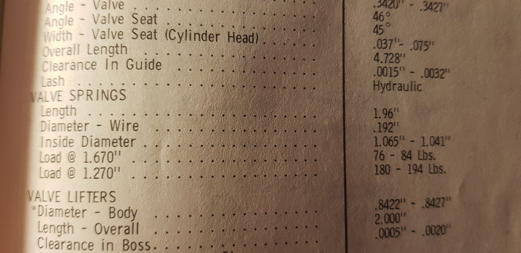

To be honest - no, i havent checked the Melling springs for pressure. I assumed that this is not needed when doing a simple stock replacement process, unlike when installing a aftermarket cam.
I only measured from the bottom of the spring pockets to to the retainers/rotators to make sure that the installed height is 1.670, which it is.
Right after i installed the springs, the problem was fixed for some time, but in fact that it came back, its maybe a sign that the Melling springs arent the best quality. Who knows.
What i find a bit odd that it seems like no one here is replacing valve springs to stock specs. I mean, a lot people drive these cars around with stock engines, and due to 50 year old valve springs, i thought its common practise to replace them somewhen.
Its even hard to find a bit stiffer single valve springs with the same dimensions and installed height like the stock ones are.
And that is exactly the same specs as the Melling VS720
I'll be honest with you, I am not an Oldsmobile "guy" as far as performance goes but I would be very surprised if that engine even when brand new would easily turn to 5000 rpm. I bet it would be done with at about 4500
Maybe some of the real Olds guys will tell me I am wrong
As far as getting rid of the rotators, most GM rotators make the installed hgt about .120" shorter compared to the stock flat retainers. They make valve locks that move the retainer down on the valve .060" That combined with a .060" shim and it should be pretty close. I don't like piling up a bunch of shims if it can be avoided.
