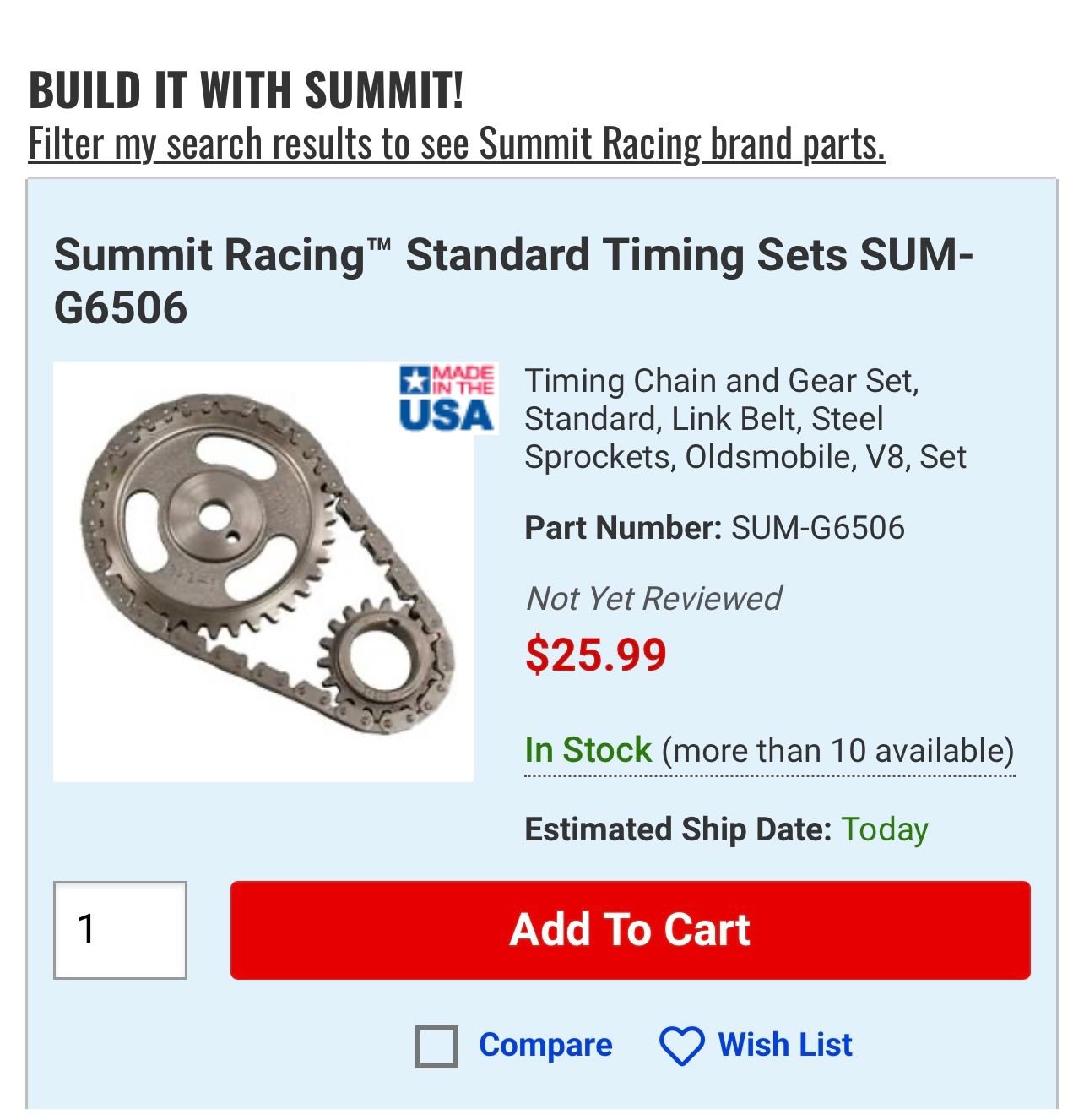

Old Aug 28, 2023 | 09:39 AM
Purepony's Avatar
Joined: Feb 2022
Posts: 55
E
Would these be ok for a stock motor? I’d like to keep the car as stock as possible
Old Aug 28, 2023 | 10:08 AM
Posts: 42,475
Have you tried your local parts store where you would not have to pay shipping? I like Cloyes brand sets.
Old Aug 28, 2023 | 10:23 AM
Purepony's Avatar
Joined: Feb 2022
Posts: 55
great point I’ll do that today
Old Aug 28, 2023 | 11:09 AM
redoldsman's Avatar
Proud Viet Nam Veteran
Posts: 10,815
From: Rowlett, TX
I think Cloyes is the best. When you have the timing cover off, check the nuts for the water pump. Some guys put new ones on and tack weld them to the backside of the timing cover.

Old Aug 28, 2023 | 12:18 PM
Purepony's Avatar
Joined: Feb 2022
Posts: 55
Originally Posted by tnswt
Call Bill and he will get the correct timing set to you. Excellent to work with.
BTRPerformance.com
email: bill@btrperformance.com
phone: 585-303-7560
thanks but I ordered it from summit about half hour ago I’ll keep him in mind for next time
