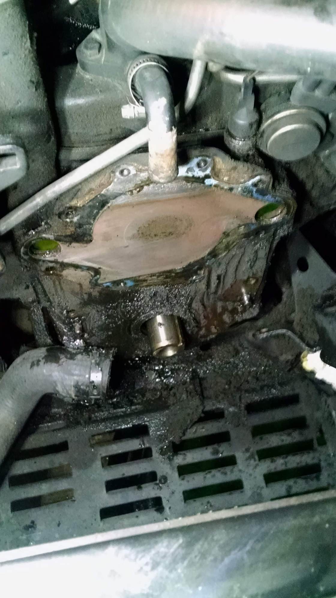

I am not sure about painting it. Personally not sure if I would want the chance of the coolant loosening the paint. Here is a picture of the one in my Wifes Riviera when the timing chain gave up. This was in 2018 and the car probably had 250K miles on it ? We have had it since new and to be honest with you I bet the coolant was not changed more than 3 times over those 30 some years. There is no noticeable rust on it.

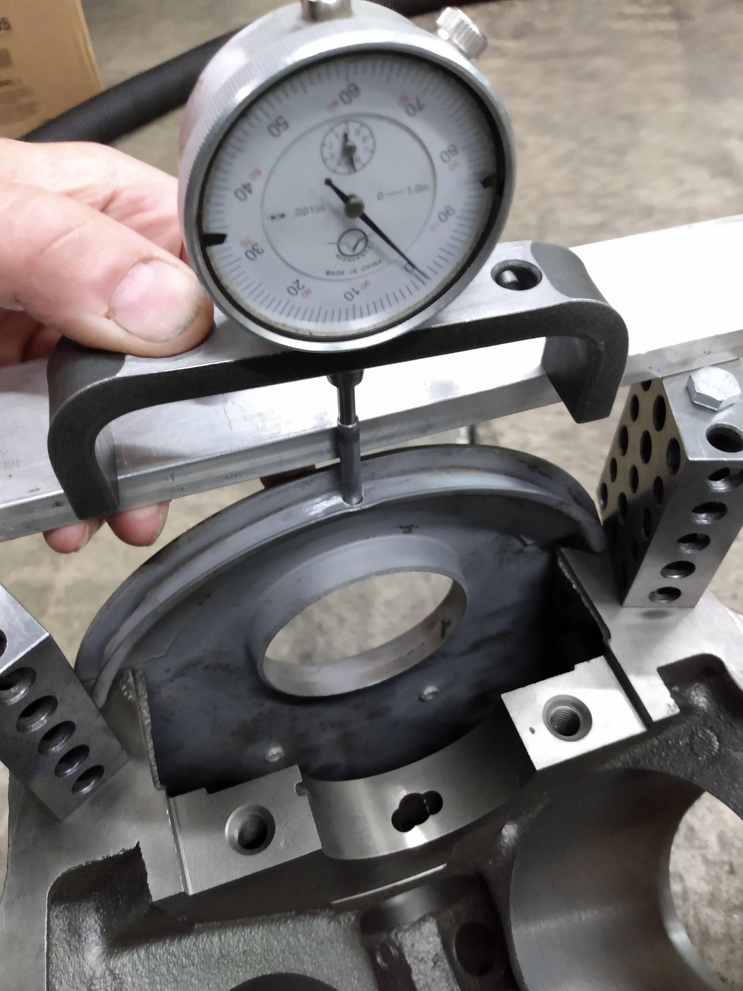

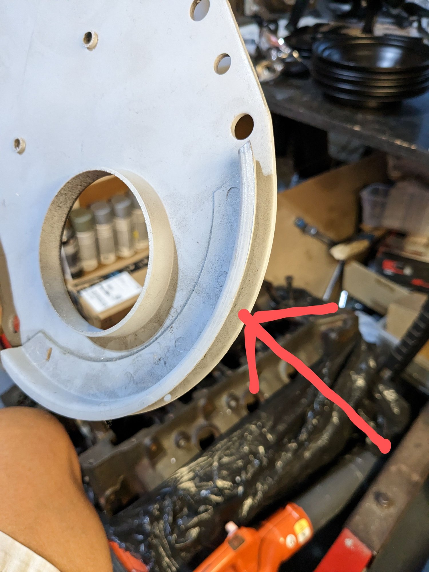

Ok, since I have nothing better to do . . . . ..
I set up this jig to measure the position of the part of the cover that actually presses on the seal. That is really all that matters. The first picture is the oem Olds cover and the second one is the one from "The parts place" As you can see they are basically the same dimension. The size of red lip I have marked on the second pic really is irrelevant as far as I am concerned. All it really does is locate the seal and keep it from sliding onto the engine.
Also, the hole where the crank seal goes measures exactly the same on both covers so I do not anticipate an issue there.
This is the second one of these front covers I have used. The first was on a 403 I did about 2 years ago and it is fine.
Skyhigh mentioned the lack of threads in the two small holes. I don't think there are supposed to be threads there. The correct screws are actually self tapping.
Hope this helps
Oem Olds cover:
Aftermarket cover:
