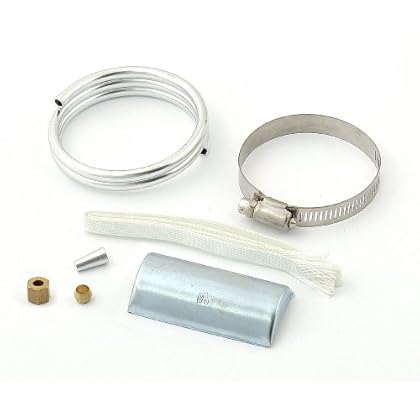

The intake will bolt to a 350. The only problem is that the 66 intake is set up for a divorced choke - the choke coil sits in a pocket in the manifold. You can use a conventional hot air choke by using an aftermarket choke stove like this:
http://www.amazon.com/Mr-Gasket-3665.../dp/B000CMF0OC
Alternately, you can also convert the hot air choke to an electric choke by swapping the choke coil.
