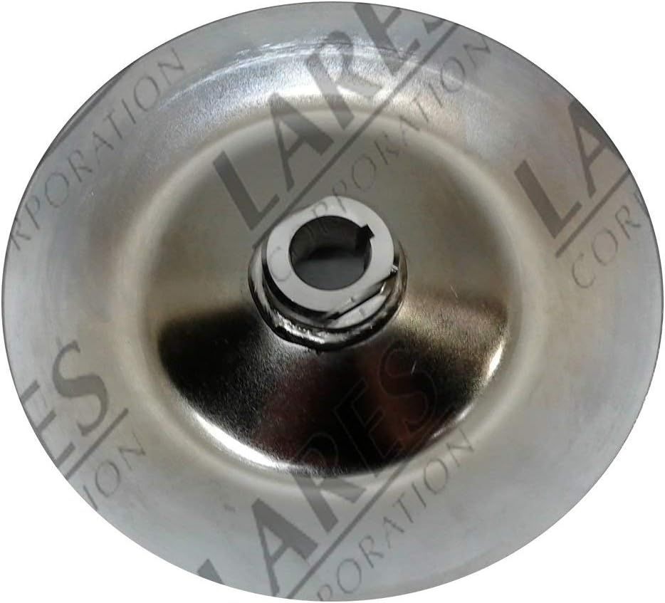

Got the new pulley today. Looks very similar to the old one. Exactly the same diameter. Doesn't say "front" on it, though. (But it does say "back" on the back! Not really.)
Old May 20, 2024 | 12:40 PM
Posts: 15,407
I see the new one has flats on the shaft mounting area so you can hold the pulley from turning with a wrench while cranking on the nut.
Old May 20, 2024 | 12:46 PM
jaunty75's Avatar
Posts: 15,188
From: southeastern Michigan
I noticed that. A nice touch. Would've been nice for the original pulley to have that.
