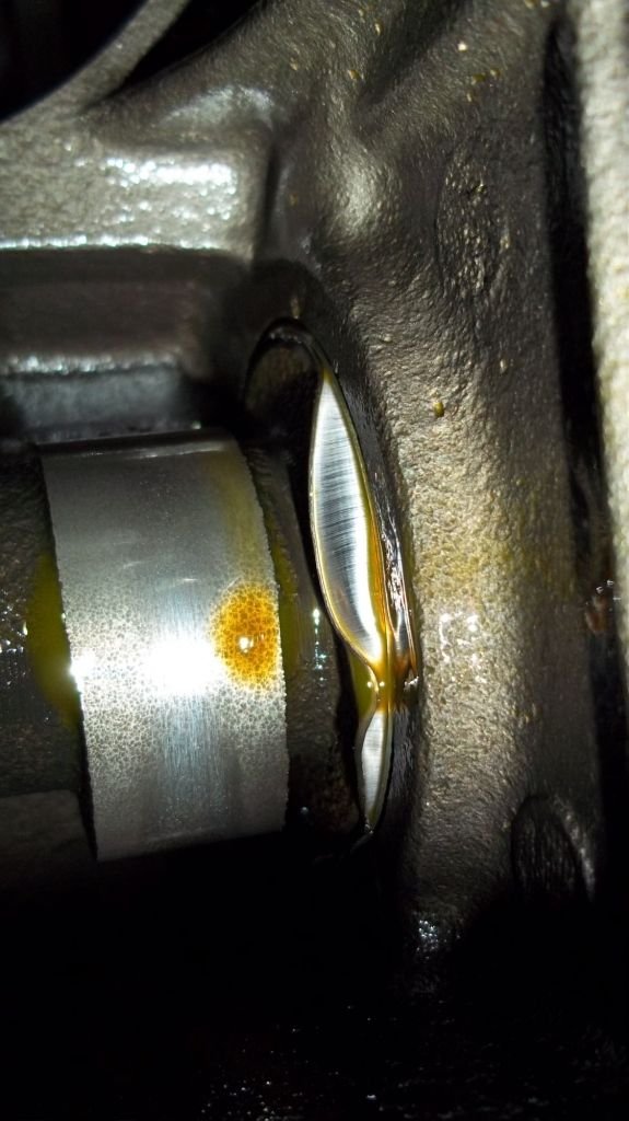

I would run, not walk, away from an ATK engine. I purchased an ATK reman 4.0 Jeep engine for a Comanche through O'Reilly. Engine #1 lasted 272 miles before developed a significant RMS leak. When I pulled the pan I saw that it had started spitting up cam bearings. ATK blamed me and said I didn't prime the engine. I sent a pic of the gauge showing 72psi on the engine stand. Then they said that, if I paid out of pocket to ship it to them they "might" warranty it. I asked O'Reilly to step in and they helped get engine #2. Engine #2 ran for 100 miles and an identical RMS leak start. I said to &^%% with it and sold the truck. I couldn't get my money back.

There was machine work on that 4.0 but, in hindsight (always 20/20) there were a number of questionable things about that engine. If you look at the cam in the pics above you can see the cam isn't new. In fact my theory shut ATK's argument down cold. They got really quiet when I asked them if the cams were shot cleaned prior to being reused. The journals were mottled, consistent with shot cleaning, and I believe it put residual stress in the old cam. When the engine heat cycled the cam turned into a banana and started walking the bearings out. While they would never confirm or deny my theory it was at that point they offered to pay part of my claim. Prior to that it was no, no, no...
Also that engine had 3 #3 connecting rods, it had the incorrect cam bolt (no thrust button), there was no evidence of the crank and rods being balanced, I found stop leak pellets in the block, a few tapped holes that I had to chase, etc, etc. How well did the gang in Monterrey, MX machine the block? While I didn't mic the crank and use a bore gauge on the cylinder walls I'd say it was machined with the same care (or lack thereof) they used in assembling it.
ATK is THE reason I went looking for a local machine shop when I needed an engine for my '69. It's also THE reason I have a core Jeep 4.0 in the basement now. When the time comes that core will be rebuilt to go in the Comanche I bought to replace the one that got 2 sub-par ATK motors.
