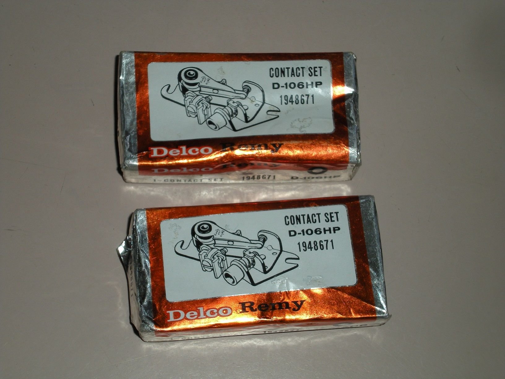

72 Cutlass Supreme Convertible with a 350. I'm just wondering if anyone has an opinion on the best manufacturer? Fusick only sells the AC Delco.
Follow-up question: If I'm changing the points, should I go ahead and change the condenser?
Thanks

Brand, I don't know but would expect AC Delco to be fine unless it is a high revving performance application. Change the condenser? Yes.
Old Jul 2, 2024 | 10:29 AM
Posts: 50,799
All new AC Delco parts are imported. I just went through this problem with my 69 wagon. If you can find New Old Replacement Stock Delco points in the foil box, those are good. I just installed Accel points, condenser, and coil in my car and so far so good, but I don't have a lot of miles on these parts yet. The previous ones (Standard Motor Products) crapped out at 2700 miles.

Look for the Delco points Joe mentioned in the foil box on ebay. The part number is 1931988 and the condenser is 1932004.

It's been half a century since a car left the factory with points. And it actually isn't the points that are the problem, it's the condenser. When these go bad, they cause the points to pit far more quickly.

The points I just bought from O'Reillys, the contacts didn't meet flush. Manufacturers defect. But I agree with Joe's take on the condenser.
Thanks Glenn for the direct to eBay for the Delco Remy new old stock.

Go on ebay and put in a search for the old delco’s. Or search the for sale thread on here. I bought a couple sets off somebody on this site a few years back..

I sold a set or two to somebody on this site....may have been Andy...don't remember and I periodically clear out my PM box so no record there.
I have a few of these NOS sets left but don't have any condensors.
Send PM if any interest.

The very very best ever is the old === Standard Blue Streak === with all Copper Contacts , the Screw for Adjustment, and their own innovation , the bracket with the wick that , kept wet, will eliminate all side to side play on the distributor….
Discontinued nine ( 9 ) years ago —- my guys demand quality —- so I still have *** BLUE STREAK POINTS *** , *** BLUE STREAK CONDENSERS *** , *** BLUE STREAK ROTORS *** , BLUE STREAK CAPS ( BLUE in Color ) and
*** N.O.S. DELCO U.S.A. ( BLACK in Color )….. ( I spent $ 25,000 9 years ago so I would have it for the Quality Seeking Men and Women….. )
