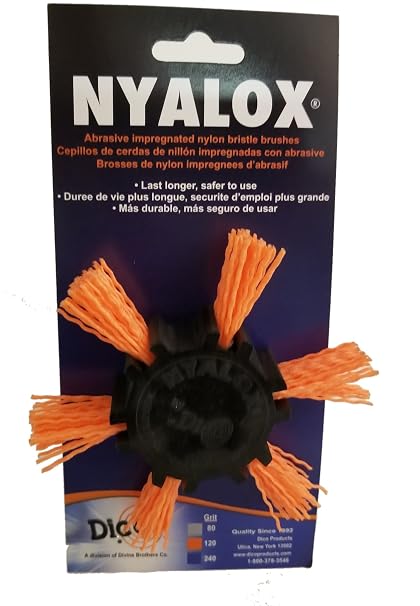

I did exactly this with a 1955 Plymouth six cyl., as one similar example. DIdn't take much pounding to get it free. Didn't take any honing or other goofing but I did flood the cyls with whatever I had, probably WD-40 and oil. One of these is the answer for rusty iron without introducing any stone grit or steel wires flying around, used with any modern battery drill. Good luck ~
https://www.google.com/search?q=Dico+orange+brush&source=lnms&tbm=isch&sa =X&ved=0ahUKEwipx5bLrvfdAhXug-AKHYMpCToQ_AUIDygC&biw=1366&bih=626#imgrc=_
