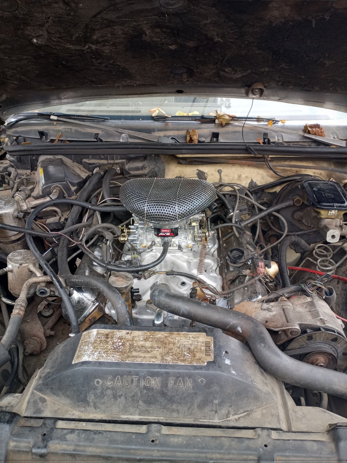

Hello I have a 1986 buick regal with a 307 olds engine in it im getting a oil choke light after driving for awhile it only comes on at stops I have put a edelbrock intake and carb on it not sure if the car was doing this before hand I put these parts on directly after buying it listening to my cuzzin who is a mechanic the intake has no egr and I caped a few vacuums on the intake as well.

I see another very dangerous situation there. It appears in your first pic, you have a rubber gas line from the fuel pump to the carb. I have seen many special cars lost due to that same thing. Get rid of it and put in a steel line. If you have to use rubber at each end, make it as short as possible.
And make sure the fuel line is rated for current gas/ethanol blends because ethanol will eat regular gasoline line
interesting will look into that I recently put a spacer on cause i though I was having a vapor lock but that maybe the other issue I'm dealing with thanks

Old Aug 4, 2022 | 05:36 AM
  #39
Posts: 50,815
Originally Posted by lilcarl
I don't know but I'm sure it is higher with the high performance intake unless edelbrock blew smoke up my butt lol in going to test the oil pressure and see what I get
RPM in gear at a specific speed has nothing to do with the intake or anything else. It is purely a function of the rear tire diameter, rear axle ratio, and transmission gear that you are in (yeah, with a little added fudge factor for converter slippage). You can calculate this just by knowing those values.
Old Aug 4, 2022 | 04:28 PM
  #40
olds 307 and 403's Avatar
Out of Line, Everytime😉
Posts: 10,132
From: Melville, Saskatchewan
My main point about rpm at idle in gear is if it is really low, bumping it up slightly may be enough to stop the light from coming on.
