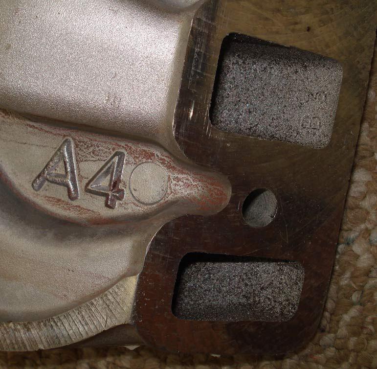

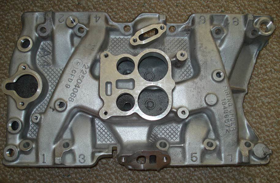

The key is, if you want one, look for the A4 on the intake. If you see A5, that's the peanut port job. You don't want that one.
Here's an NOS one I got for a project. Note the A4.
Also has A4 on the bottom, too.
