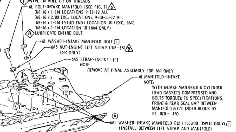

I am trying to determine if washers were used on the factory engine lift loop located at the front driver side intake manifold. I looked at a whole bunch pictures of Olds engine. Not sure which way the factory bolted down the intake manifold. All the bolts have thick washers under them. Not sure how they bolted down the loop. Were 2 washer used on top of the loop? Were 2 washers used under the loop?Or did they use no washers?
Someone have a nice original engine they can check for me?

The 70-72 W-30s had washers under them from factory but i am not sure about the iron manifolds. It will be in the engine assembly manual but I can't look it up till later.

My 72 350 engine Iron manifold never apart (till me) The loop bolts had no washers, the loop takes the place of the washer.

Thanks for the great info guy's. My 77 CSM doesn't show the detail on the manifold.
I think Schne442 maybe correct. I can't find 2 of the washers, I assumed I misplaced them. If they were not originally there , then perhaps that explains why I can't find them.
It's from the 1970 engine assembly manual
