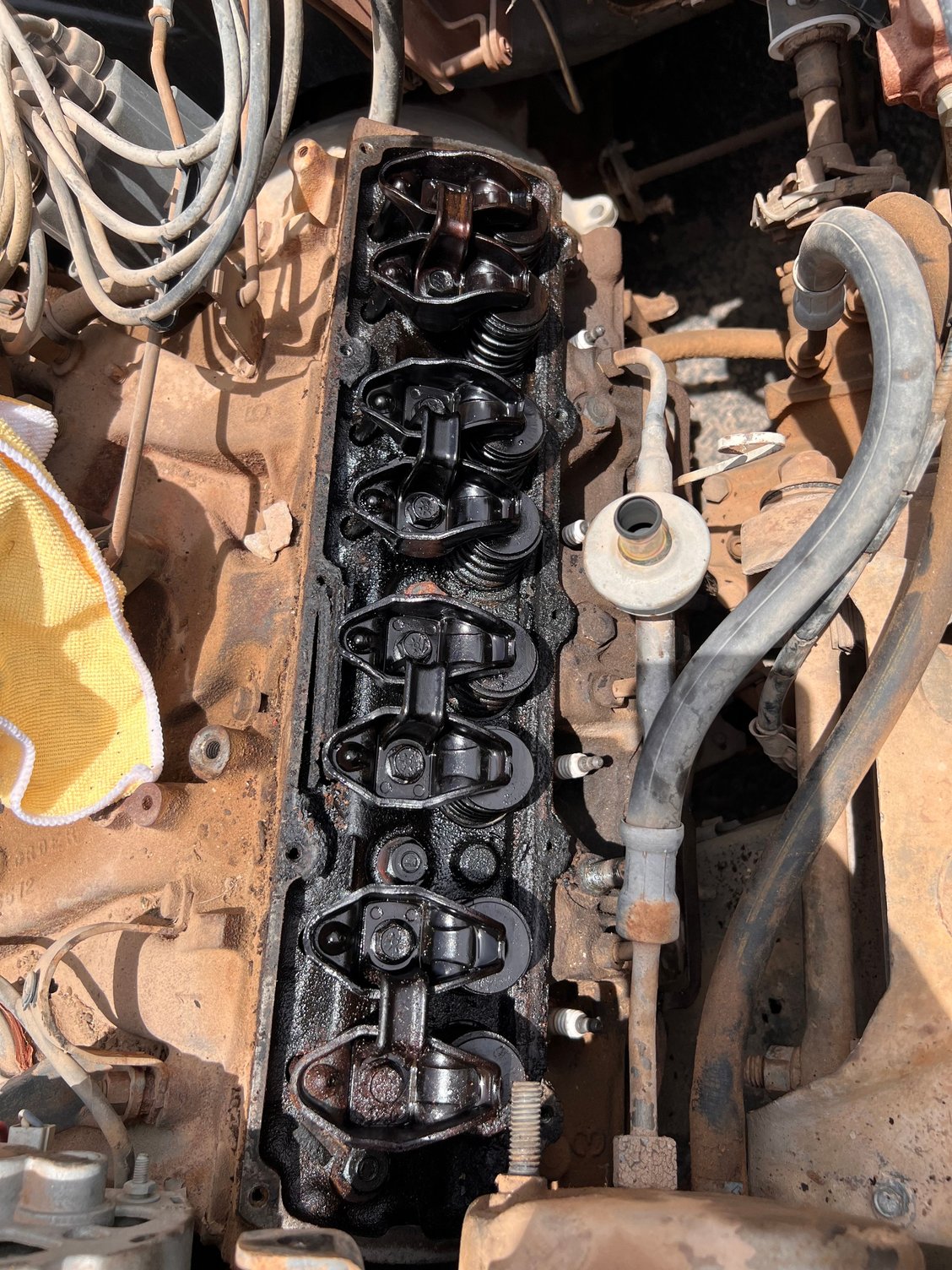

So I pulled my valve covers today on my 66 Jetstar. 330 btw. Driver side seemed okay, and the passenger side is quite rusty. I’ve never messed with engines before so I don’t know if it’s safe to put back together and run for the time being.
heres a pic.

You wouldn't be sure until you at least had the heads off. That rust looks like it is from condensation not immersion. You might dodge a bullet and only need to address the heads.

It would be nice to see the hardware w/ less caking; yet, to your question - is your engine cooked?
A brief review demonstrates you purchased the car last year; and, it's a nice car.
To the point:
Does the engine run? Has the engine been tuned in compliance with the Oldsmobile Chassis Service Manual (CSM) specifications? Maybe the engine/car sat for some time before you bought it contributing to what appears as moisture & fouled oil. Don't give up the ship quite yet.
First step. Get yourself a compression gauge and perform a compression test. It is a very simple test which will provide you w/ knowledge of the overall health of the engine. Tons of literature & videos available on performing a compression test - do your research. I'll note it's far easier (especially on the starter/ignition) to remove all spark plugs. Come back w/ the results of the compression test & members can provide plenty of advice.
^^x2^^ Could be likely nothing more than lots of condensation/moisture which contributed to the fouled appearing oil. A compression test will determine overall health of your engine.

You'd still want to pull the heads to have the valve guides checked. Plus replace the valve seals because they'll be plasticized by now.

Depends on what you consider "cooked". I would want to know if any oil is getting to the rocker arms on the passenger side head. You'll still need to remove rocker arms and push rods to wire brush them to remove all the rust.

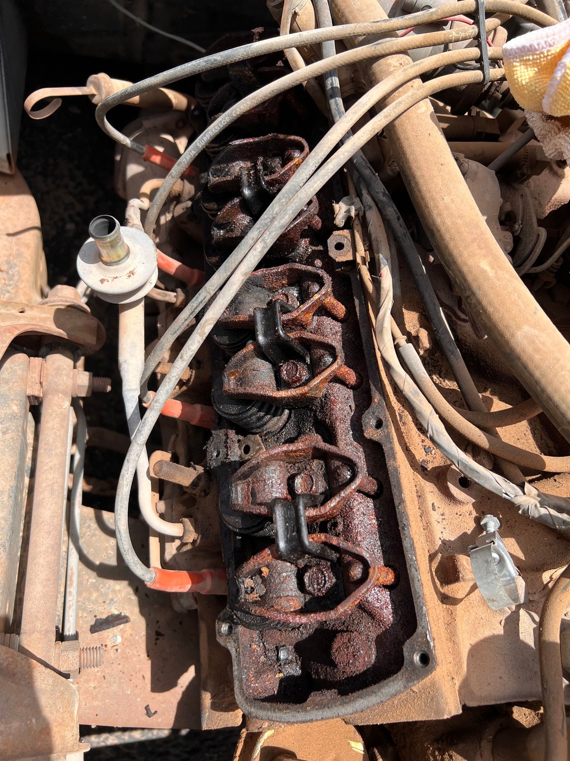

Se
Seems like mostly surface grime and rust!

I’ve never bothered putting pushrods back where they came from or orient them, same with rockers. Only thing I do is keep bridges matched to rockers, having said that it’s not a bad idea to put things back the way you found them.

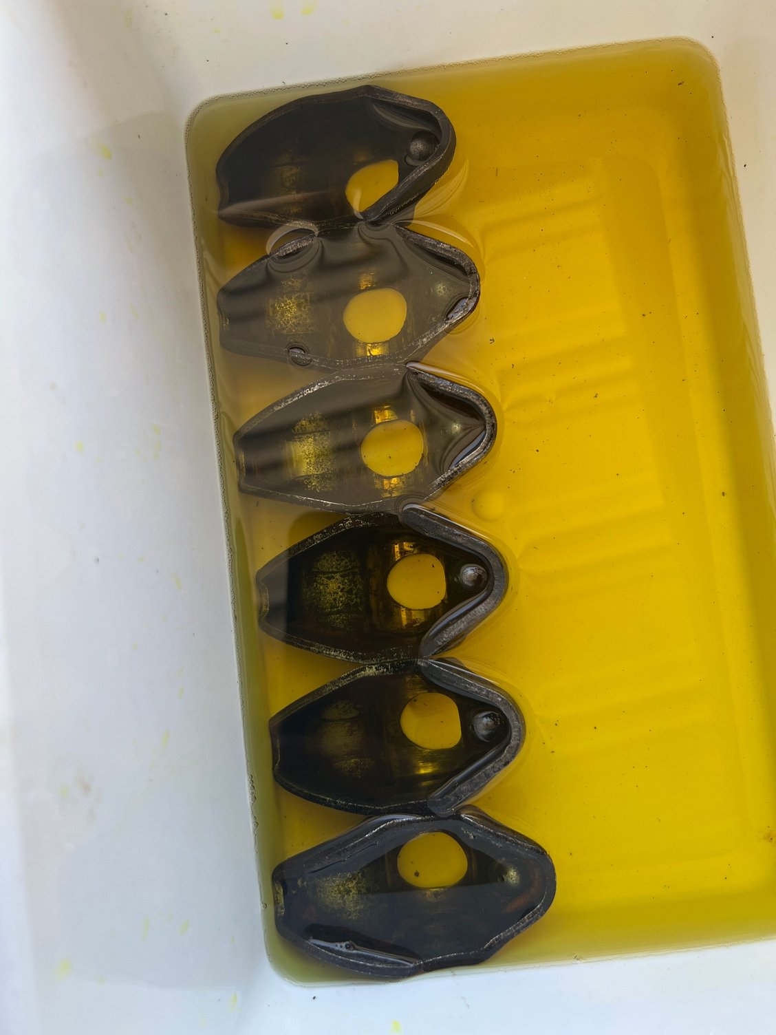

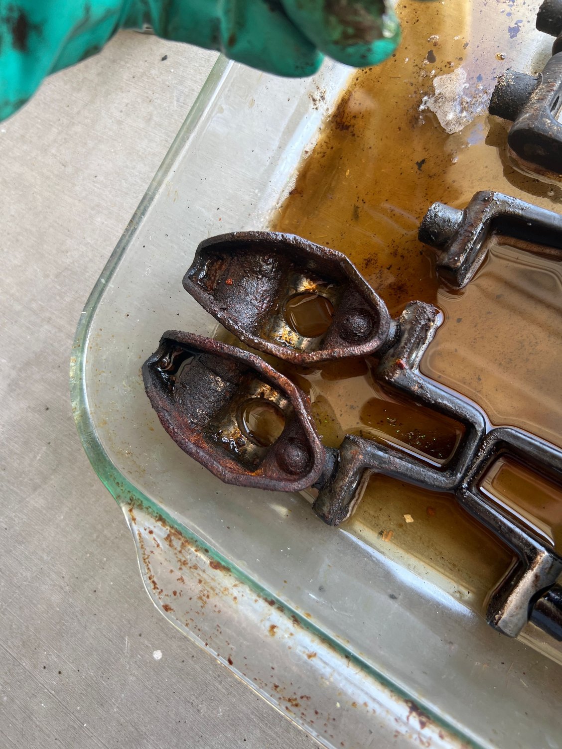

Alright, everything is clean. I did spray the pushrods as two were clogged and some others partially clogged. I’m unsure of how to clean the gunk out of the heads. Pulling them isn’t really an option right now.
any tips or ideas?

Poke a wire down the drain holes. Be aware there could be slight mismatch of the drain holes near the deck surface. Mark the wire to know when you got to the valley area.

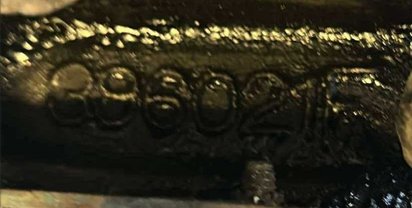

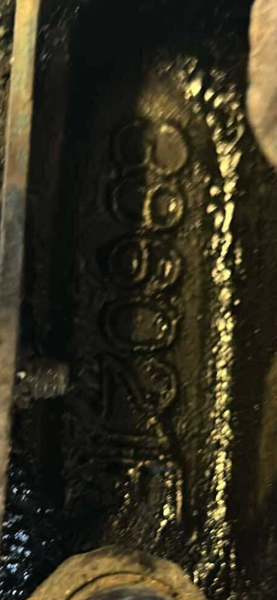

allso, the car has been concsuming coolant since I have had it but I have not noticed any smoke from exhaust, fwiw
meantime I found an engine while taking a lunch break.
can you guys decipher if this is a 455 and any other details?

396021 F was used on 455 blocks from 1968 through 1974. Others can validate.
