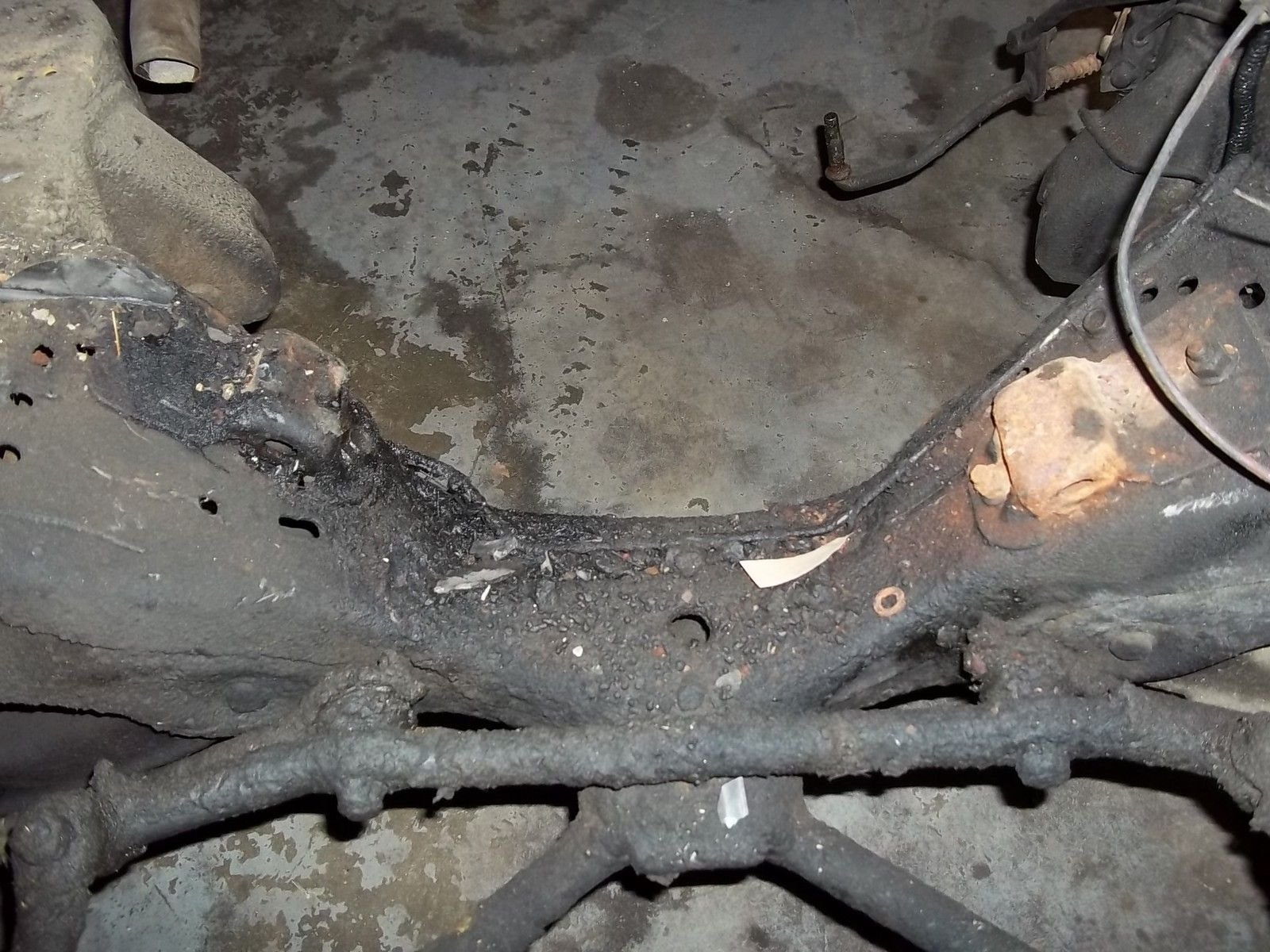

Assuming that is the 260 V8 diesel and not teh 263 V6 diesel, any 1964-1990 Olds V8 bolts in. Note that diesel cars offset the driver side motor mount and frame pad forward to make room for the diesel starter. There was an adapter plate bolted to the block to provide an attachment point for the motor mount. This photo shows the diesel location for the frame mount on the right. For gas engines they are directly across from each other. You can see that the holes are already drilled in the frame for the gas engine location of the frame pad.
You can transfer the adapter plate for the motor mount to the gas block, but that motor mount location might get in the way of headers if you plan to use them.

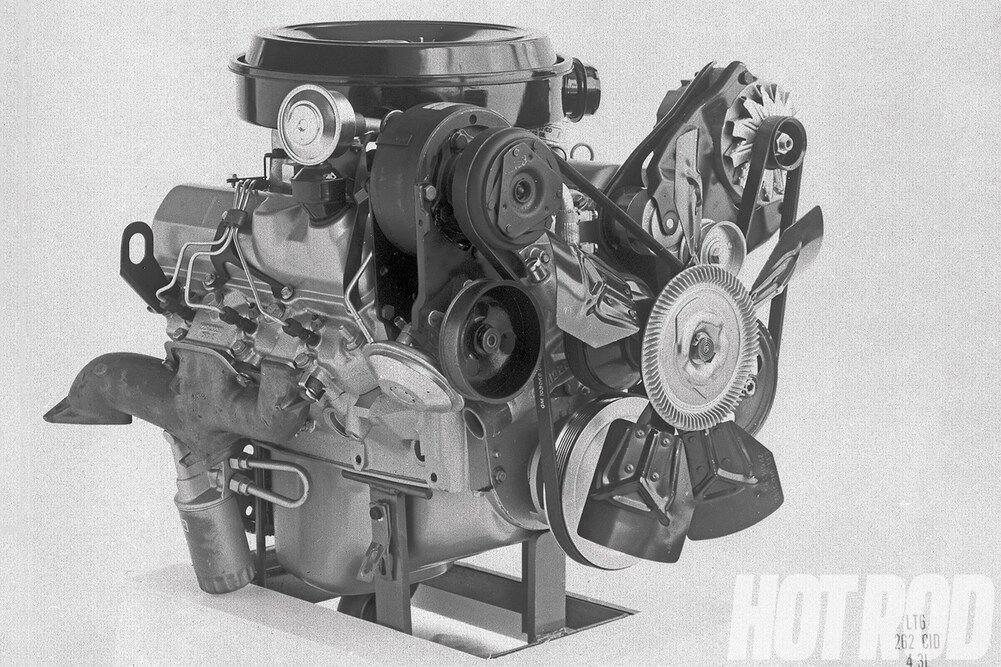

Posts: 50,802
Originally Posted by Reese Neis
what would be the case if it was the 263
Not sure, as this photo doesn't show the driver's side. The passenger side mount appears to be in the same location as for a V8.
